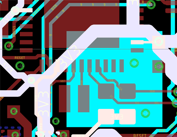

Hi!
The board has a short between 3v3 and gnd and I cannot find it using drc/erc.
I have overlaps for sure. Those are mainly due to me drilling in pads. I have gone through all overlaps related to gnd and 3v3 signals.
The dru is from OSHpark and their published tolerances for a 4layer board.
Tried measuing resistance on board but maybe my multimeter is too simple to show anything. But since the board is not populated and still shorted thats a bad idea.
From a schematic perspective the 3v3 and gnd cannot be shorted since they are not connected. Has to be on the board side, right?
Trying to determine if I should go back to OSHpark or not. Got three copies and they are the same so thinking this is a design issue more than anything else.
Any ideas?

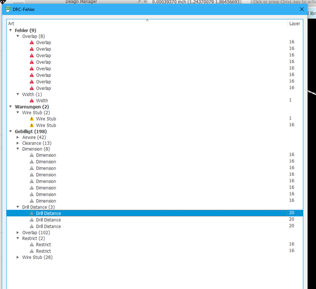

    I know there where a lot of DRC findings on the board.
    Airwires:
    I was too lazy here for sure, If I find these really short airwires I just confirm the routed line is on the pad (I.e copper i solid)
    Must be something in the way I work with Eagle that leave this small gaps. I think Its related to how I place the (micro)vias in pads.
    I have done two layer boards for a year of so and for me plating (tenting the via?) is not an issue. I do know these holes will suck down solder.
    And a few of my smaller components on this board has thermalpads where these 4-5 microvias actually make up a significant area of the pad.
    I try to fill them my self prior to applying solder via stencils. These are one-off's so I assemble the board manually. For production runs I would either not place them in pads or go for more expensive manufacturing where vias are tented(plated)
    Clearances:
    I'd like to think I addressed all clearances not related to vias in pads. But CLEARLY you found one I must have "passed" in a hurry. Will never do that again!

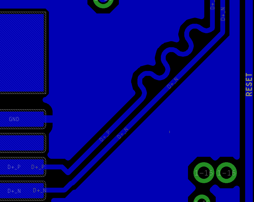

    Thanks Jan for looking into this. Early morning so I will go about this today (looking at feedback).
    I did match the length of the diff pair (renaming them to D_P and D_N) match the length to 100% vs 100%).
    And placed ferrites close to USB receptable. Realize more rules goes into this I.e what goes underneath and so forth.
    It's a bit of a learning curve for sure!

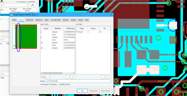

  • geralds
    geralds over 7 years ago in reply to frippe75
    Hi
    I think you have design rules problems.
    You've set the via from L1 to L16 but your power 3V3 goes to L2. That causes an overlap on this pin.
    Here you either have to put the Via only between L1 and L2 - Layer Settings, or a blocking area on the L16 make sure that the GND area (polygon) does not short here.
    Then you have approved a lot of mistakes that are not! may be approved.
    They are e.g. air wires, wire stubs, restricts, distances, clearance
    Wire stubs can be approved if they are not too close to the neighboring tracks.
    Also check the part names and labels especially on the holes and components.
    You can adjust the font sizes and styles to avoid overlapping the holes.
    This was a first check. Please make the ERC and the DRC so often that it fits and no approval is needed.
    Graphical details in the part borders can be switched off, but it is worthwhile if these are also checked.
    You can set this in the design rules, or activate in the menus.
    Best Regards
    Gerald
  • autodeskguest
    autodeskguest over 7 years ago in reply to frippe75
    On 17/02/2019 21:18, Fredrik Tarnell wrote:
    Hi Rob,
    Just think I ignored them in general or a particular one.
    They are (from a brief look) all 1-16 vias, which connect all layers.
    The particular one I highlighted is in a 3V3 pad on layer 1 and a GND
    pad on layer 16. That makes a dead short from 3V3 to ground.
    Have been ignoring the overlaps due to drill in pads and close to pads.
    Drill in pad is generally a bad idea, which is why you get the warnings.
    It is possible to assemble boards with via in pad as long as they are
    micro-vias, but if you put a normal sized via in a pad you are asking
    for serious problems.
    But they are the same signals. Could it be that I'm chasing one via which is "infront" of a another via or something similar?
    Like I said, the specific via I highlighted absolutely is NOT the same
    signals in all layers.
    Jan Cumps over 7 years ago in reply to frippe75
    Meandring USB signals are advanced topics. Maybe focus on all the basic layout priciples first? Get that USB ones as close to the edge as possible and forget about them. Focus on all those other components.

  • autodeskguest
    On 17/02/2019 18:25, Fredrik Tarnell wrote:
    Thanks Jan. Uploaded the brd file to my github
    https://github.com/frippe75/Medbee
    I think this is your problem. The DRC caught it but you've ignored so
    many overlap errors that you didn't see how important this one is.

    Have a USB diff pair that I didn't meander to matched lengths and so on. I will be ordering another itteration of my board but was hoping to get it off the ground at least. But VCC->GND short ruled that out...
