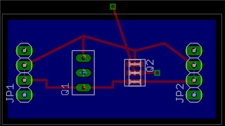

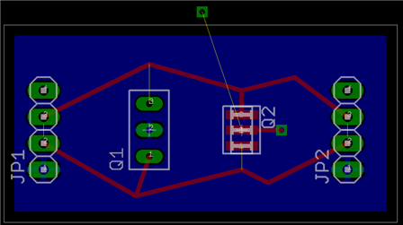

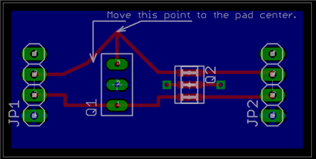

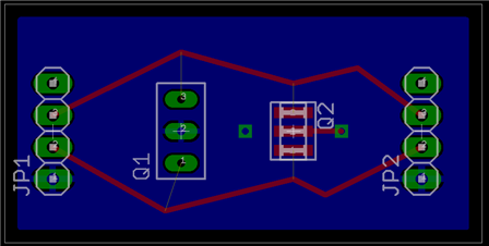

    How to connect two traces to the same pin:
    Picture 1: one GND via has no connection to GND pin
                   (because it is connected to GND polygon):
    Picture 2:  One signal pad and one signal SMD connected.
                    Non-connected GND via moved outside of GND polygon,
                    so after "ratness" command an air wire appears:
    Picture 3: via and pads connected:
    Picture 4: both vias connected:
              Best regards,
                    Lev Freidin.

  • Richard_H
    Richard_H over 15 years ago in reply to flozzi
    Hi Michael,
    EAGLE allows 1-2-1 connections with pins and pads only. There is no option to connect one pin with two pads, sorry.
    What you could do is to draw a WIRE in the layout that covers the second pad or the correct way would be to use 4 pins in the symbol and connect each one with a pad.
    Best regards,
    Richard

  • flozzi
    flozzi over 15 years ago
    How can I connect X2Ydecoupling capacttors from Johanson wiyh EAGLE? I should connect each pin twice!. If I connect the first pin, the airwire disappears.
    Thanks,
    Michael
