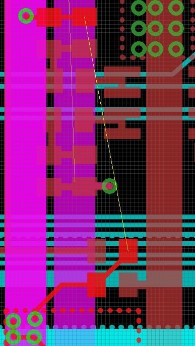

  • Richard_H
    Richard_H over 15 years ago in reply to e14 Contributor
    HI,
    just saw your message here, after answering the same question in german. But here you attached a picture which could help a bit. When you use RATSNEST for calculating the polygons, are the polygons filled? Do they have the name of the signal the should belong to?
    It is difficult to give advice here, could you send me the board file via private email to supoprt@cadsoft.de.
    So I can take a look into it.
    Regards,
    Richard
    e14 Contributor over 15 years ago
    Hi richard,
    I´ve got a hand routed layout. Though each net is physically completely connected there are still air-wires left (see attached picture). Ratsnest brings no change. Is there any solution except of routing those air-wires ? Using the Auto-Router is no option - it´s an hf-design.
    Thanks in advance
    Uwe
