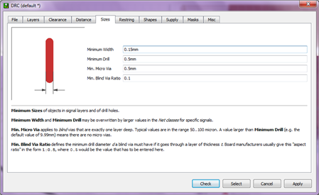

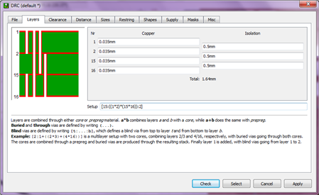

I'm designing a circular board with a BGA and lots of different IC's on it and I'm having various problems. I'll start with my first one, regarding Blind Via Ratio error in DRC:
Layers setup in DRC:
Sizes setup in DRC:
I end up with these warnings everywhere:

    e14 Contributor over 16 years ago in reply to Richard_H
    Thank you Richard, that explains everything!

    Richard_H over 16 years ago in reply to e14 Contributor
    You defined a supply layer which is displayed inverted and has its own anullus and thermal symbols. This is reflected by the $ character in the beginning of the layer name.

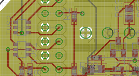

    I changed my layer settings to only have one via type and the problem went away, on to a much more urgent problem:
    I have a supply layer (GND) that doesn't behave like it should regarding clearing room for vias and THT pins:
    (brown is GND plane obviously)
    My layers:
    And the GND layer:
    The fill layer does however treat ground pins/vias correctly:
    I need help urgently to solve this matter, any help is deeply appreciated. I'll send brd file on request via mail.
    Hi Peter,
    the problem seems to be in the settings for Sizes in the Design Rules. You have 0.5mm for micro vias and for 'normal' vias. This does not allow EAGLE to dinstinguish between them and I suppose this is the reason for the errors. Usually the value for normal vias is higher than for micro vias. As far as I can see it from your Desing Rule settings, I think you don't use real micro vias. What happens if you decrease the micro vias value?
