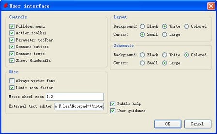

Is there anybody knows how to use parameters %C, %F and %L when designating an external text editor in EAGLE's Option Menu? I just learned from Internet that %F means only if this parameter is added in the command line, like "C:\WINDOWS\system32\notepad.exe" "%F", the ULP or SCR file can be opened directly in notepad, otherwise a new empty notepad will pop up.
Is there any more suggestions for %F? and %C and %L? Could anybody here give me some examples for the usage of these parameters?

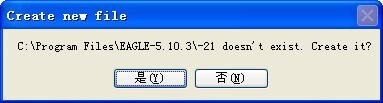

    When you write -2%L then %L gets replaced with the line number while the rest remains unchanged. If EAGLE wants you to go to the first line you'll get -21. I don't know where you took the switch -2 from, but according to the documentation this switch is called -n. Please read the documentation: http://sourceforge.net/apps/mediawiki/notepad-plus/index.php?title=Command_Line_Switches
    BTW: I already gave you a notepad++ example command line.

    I put "C:\Program Files\Notepad++\notepad++.exe" -2%L -2%C "%F" in the field of External text editor, but the cursor didn't appear at second line and second column in notepad++, instead it prompt me to create a new file named "-21"...
