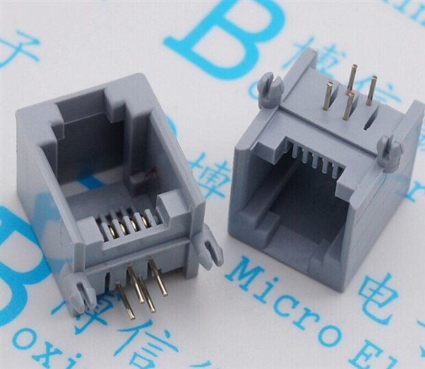

I recently bought these type of low profile RJ11 6P4C 4 Pin 90 Degree Needle Welded Type Modular Telephone Connector for my electronics project, but unfortunately I can't find any Eagle CAD library or schematic part, footprint for it.
Is there anyone who already has this part library or something?
btw...the seller didn't provide me any Technical datasheet upon my request! image

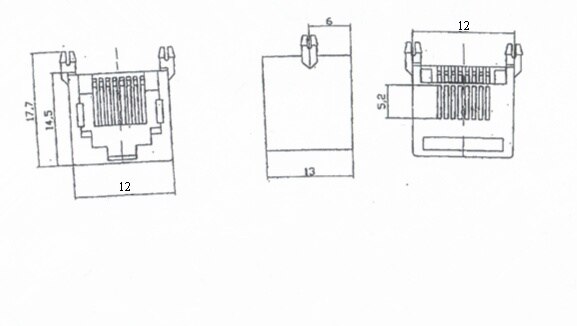

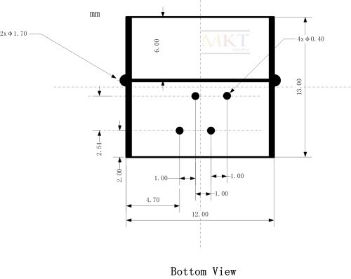

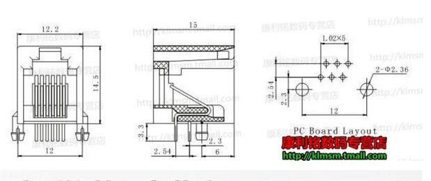

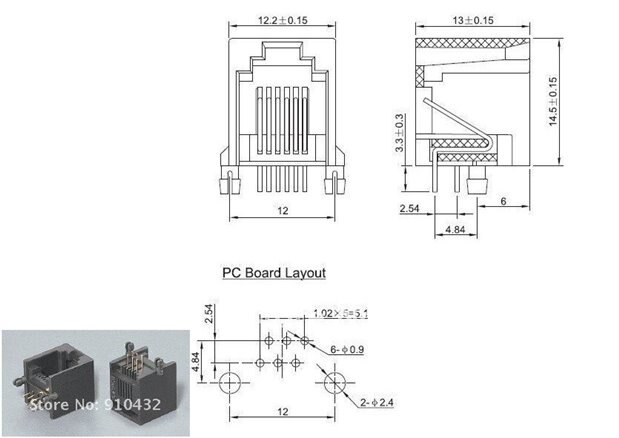

    Yes, you are right about that, finally I have found some technical data after approx. 2 month of searching!
    My issue is that I don't know how to make my custom part and a footprint, I guess I'm too n00b for that, already spent a few hours struggling with it! image
    What I have found:
    And those bellow, I think they are the same (more accurate), just shows the 6 pinhole, I only need 4 pinholes (like shown on my first picture post), if I'm not wrong.
    Figure 1:
    Figure 2:

    Hi Viktor,
    You could resort to measuring it, and constructing your own EAGLE part for it.
    If you don't know how to construct a part, it is in the EAGLE manual (and dozens of Youtube videos probably).
    Expect to spend a few hours initially practising/going through tutorials, and then ten minutes constructing it.
