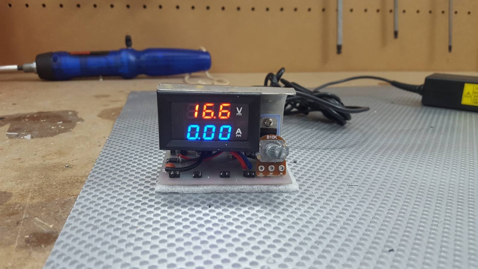

    0 aster94 over 8 years ago
    I didn't had free time to complete the projet plus item that took ages to arrive = I completed the power supply only today
    I know it doesn't looks good image but it is my fisrt experiment with eagle, pcb, etching, ecc. Anyway it works, it outputs from left to right: 3.3, 5, 12 and adjustable image
    I made some errors in the pcb making (somewhere i read that pcb never came good at the first try) first of all the DC connector was completely wrong in the schematics and also the volt/ammeter was wrong, the correct draw was from Gerald
    With this last post I would like to say thank you to all who helped me in this fisrt pcb making image
