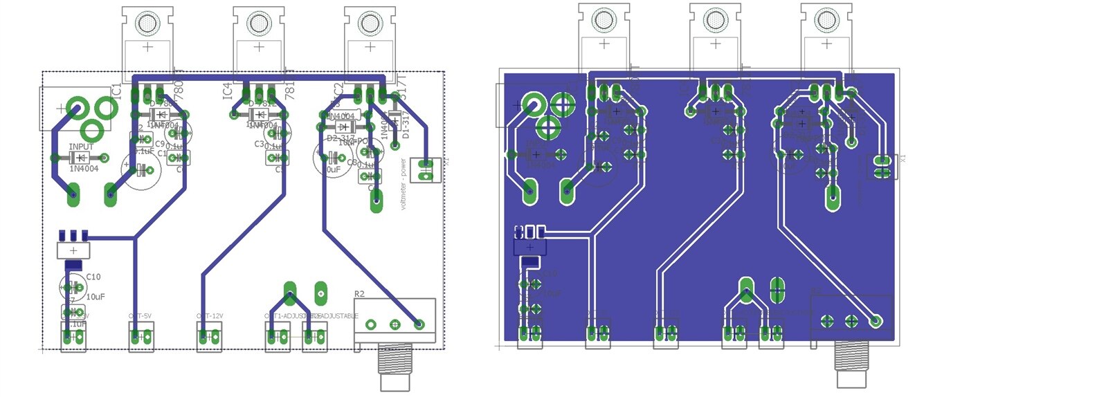

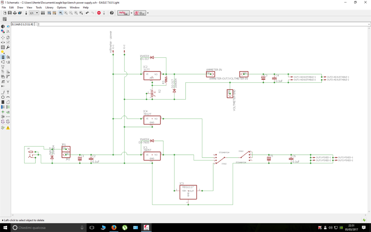

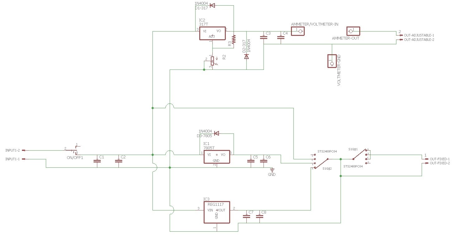

hello,
I started drawing in eagle this afternoon to make my first home made pbc board for a bench power supply that with an input of 12V/5A will have two output of 12V, 5V, 3.3V and an adjustable voltage (lm317)

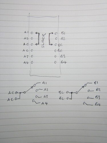

the switches are these with ground in the middle
I hope that the schematic is clear (it is also in the attachments), maybe you could give me some hint or advice about something that i m doing wrong
about the .brd i didn't route it since maybe you will say me to modify my schematic
thanks in advance

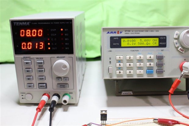

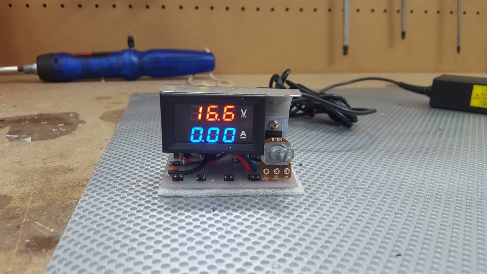

    I didn't had free time to complete the projet plus item that took ages to arrive = I completed the power supply only today
    I know it doesn't looks good image but it is my fisrt experiment with eagle, pcb, etching, ecc. Anyway it works, it outputs from left to right: 3.3, 5, 12 and adjustable image
    I made some errors in the pcb making (somewhere i read that pcb never came good at the first try) first of all the DC connector was completely wrong in the schematics and also the volt/ammeter was wrong, the correct draw was from Gerald
    With this last post I would like to say thank you to all who helped me in this fisrt pcb making image

    0 geralds over 9 years ago in reply to aster94
    Hi,
    fine, congratulations!
    A little bit:
    1) place the output connectors and poti also the V-regulators a bit to inside of the board, then you have a closed GND plane with this polygon.
    Then you don't need wire jumpers.
    2) turn the input plug backwards to the IC side then you can make a small enclosure around the PCB that have on the front- and backside the mounting parts but not on the l/r sides.
    The 100n bypass capacitors have mounting so close to the ICs as you can. They are ceramic capacitors, withstanding > 50V.
    Best Regards,
    Gerald

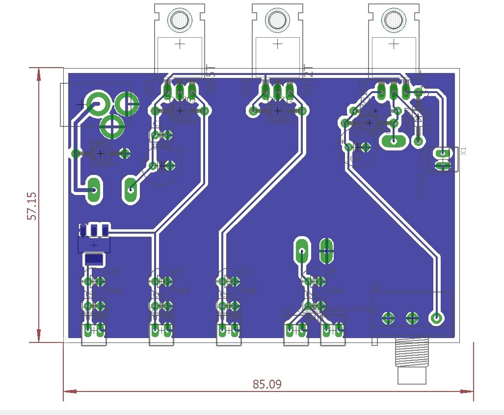

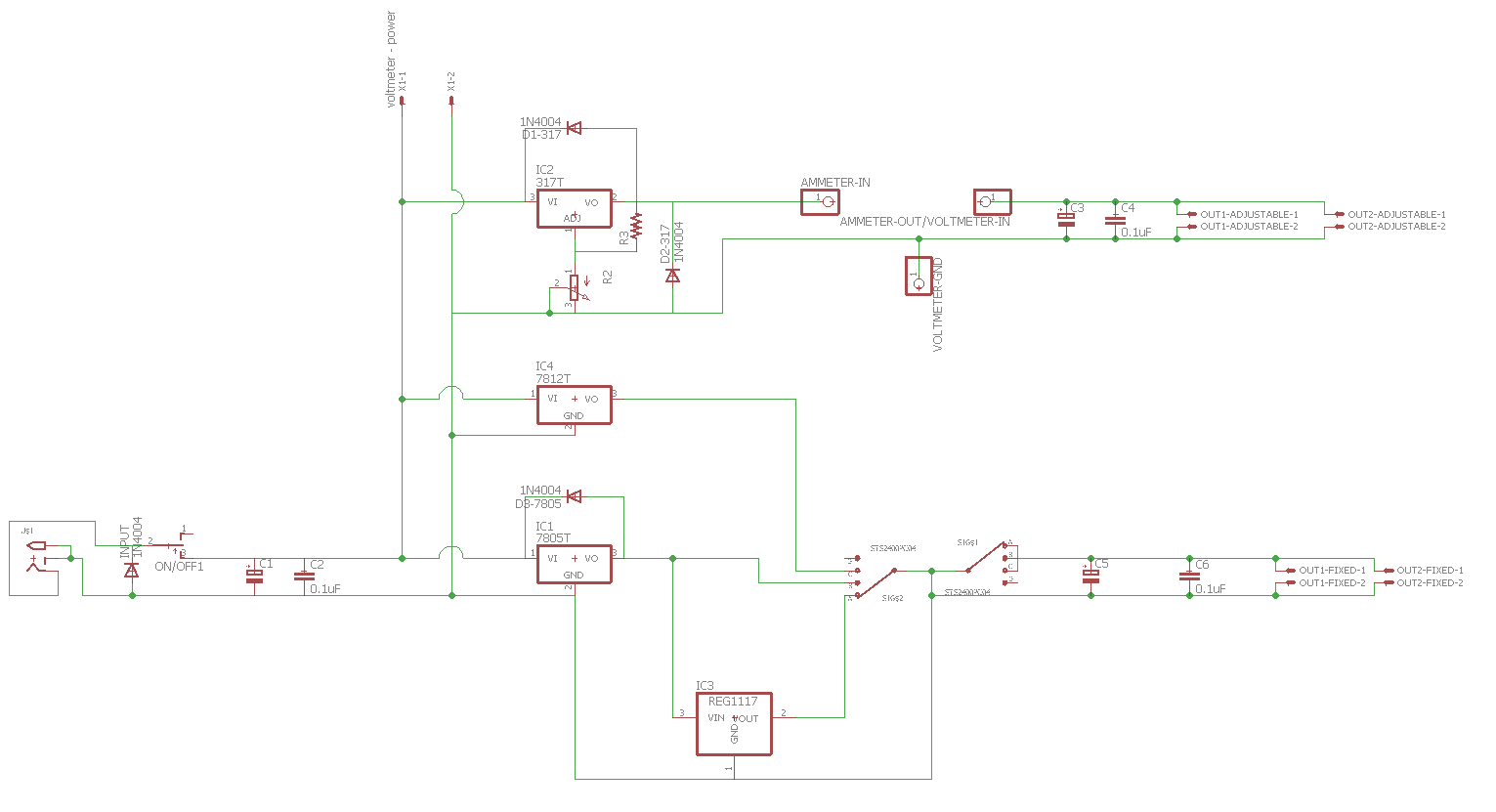

    0 aster94 over 9 years ago in reply to COMPACT
    "You seem to be focused on ancillary considerations and not the primary considerations as I've tried to lead you."
    you are right i was so focused to connect all the components in the board that i forgot to give an appropriate width to the tracks, I used this calculator: The CircuitCalculator.com Blog » PCB Trace Width Calculator  and i used 50mil for the main power lines before the ICs and 32mil after the ICs since techinically the max amp after them should be <1.5 amp
    about the capacitors i really misunderstood a previous post, i thought that they had to stay as near as possible to the outputs....
    now i think it is correct

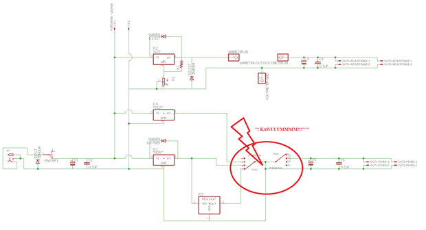

    0 COMPACT over 9 years ago in reply to aster94
    Vincenzo,
    Don't concern yourself about using power plane fills but get the essentials in order first.
    Here are some observations.
    1. PCB traces are too thin; they need to be thick enough to handle the envisaged current and be thick enough firstly to avoid acting as an unwanted fuse and handling the envisaged load.
    2.Your low impedance, small capacitance (100n) capacitors for the voltage regulator outputs are far too far away from the voltage regulators; ideally they should be adjacent.
    Have a look at Steve Ciarcia's Circuit Cellar How to build your own Z80 computer book which is available online which has a great section on power supplies for beginners.
    https://books.google.com.au/books?id=mVQnFgWzX0AC&printsec=frontcover&source=gbs_ge_summary_r&cad=0#v=onepage&q&f=false
    follow up:
    i hope that with this post i won't be seen as arrogant since I didn't use the schematic from @geralds
    His draw is obviously far away better than mine, but my main desire was to do this bench power supply on my own
    I completed the board in only one side, i used extra isolation for the ground plane than needed since i m not sure about our homemade etching quality
    Now i will just have to wait for the 7812 then i will finish it image
    P.S: I know that the ground plane is not perfect near the lm317's outputs i will put a jumper

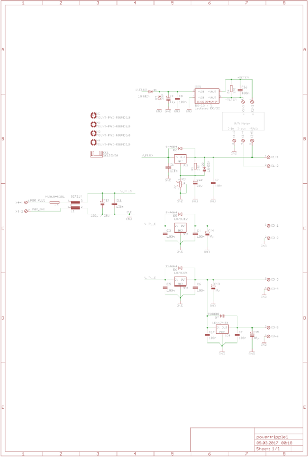

    Hi,
    Attached you'll find the schematic.
    You can use freely all what you needs; its my pleasure.
    Then with this you can build your pcb.
    There is also a heatsink on there you can mount the V-regulators.
    But use for all an isolation pad between the device and heatsink.
    Also isolate all screws.
    After mounting check it with an Ohm (wire finder) -Meter !!!!!!!
    The isolated DC/DC converter is a pcb mounted type like NME1209, or similar. An ISOLATED DC/DC converter is necessary.
    At the output of the DC/DC you have a resistor with 270 Ohm. That can be a higher value <1k (9mA, 9V); >270 (30mA, 9V)
    The thinking about is that the DC/DC needs a load resistance for regulation the output voltage to the nominal value (9V).
    With that R you makes the minimum burden current for this converter;
    see in the datasheet which minimum current it needs and then calculate the resistor value.
    Yes, IC1 is a LM317T.
    The other regulators are LDOs with attribute S - 78S12.... that have a better dropout voltage.
    At the input you find a filter - that filters out spikes from the power supply that you use for this regulators.
    -> You have to see that you use up to > 3A if all regulators are working. -> the filter with min. 6A would be ok.
    The max. input voltage will be 15V because the DC/DC converter can not more stressed.
    Here you have a zener diode ZD15V with 1 Watt. This is for security if the input voltage increase over 15V.
    But stay always under 1 Watt power lost (over voltage and current through the zener).
    I've build the schematic with Eagle V7.7.0.
    I wish you the best for your project.
    Best Regards,
    Gerald
    powertripple1.zip

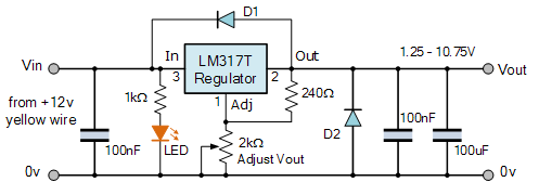

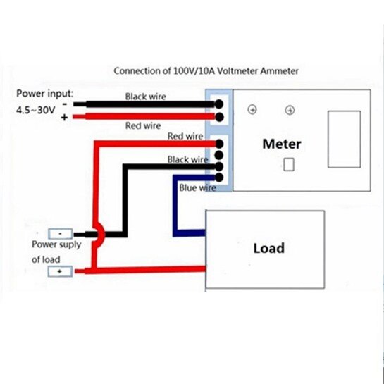

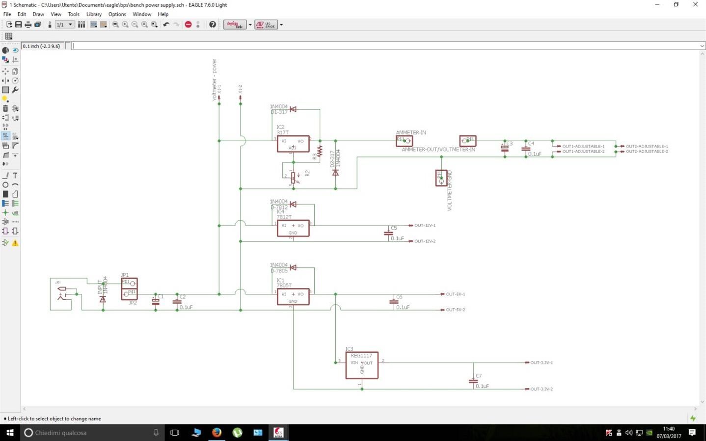

    I think i should aliment the ammeter between 4.5 and 30v and i do it (upper part of the shematic)
    For the measurements:
    black wire to VOLTMETER GND
    Red to AMMETER-OUT/VOLTMETER-IN
    blue to AMMETER-IN
    So the lm317 now is correct imageimage??
