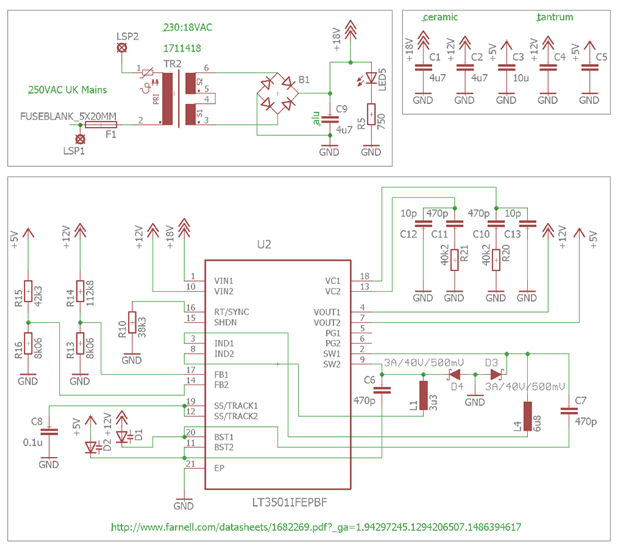

Afternoon all,
Late on a Friday, I am clearly making some sort of simple error but I am blind to it.
Please see the circuit below.  I have soldered it up and it isn't working.  I get 36VDC on what should be the regulated 12V rail and a little over 1VDC on the 5VDC rail.
Any ideas, please?  I should add that if I remove the transformer and supply 18VDC from my bench PSU then everything works fine, even after the 36V spike which is over the LT3501 max so I *think* the regulator is fine.
The number above the transformer is a UK Farnell product code.  It is a 2x 9V transformer with the secondaries wired in series to give 18V.
Cheers,
Simon
PS: Context; it is a power supply for a rPi which is controlling, among other things, some 12V RGB LEDs.

    Definitely check those diodes and increase C9.
    Do you have a picture  - this part will be very fussy about layout.

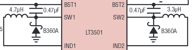

    In the datasheet for the converter, the diodes across SW1 and SW2 are Schottky diodes
    https://www.vishay.com/docs/89071/b360a.pdf
    In your circuit you have indicated they are 3A 40v 500mV, so the first question would be are they B360A or an equivalent.
    I agree with the previous two respondants that the current is too low to run a RPi, and the filter capacitor value too small.

    Some problem in the voltage dividers tied to FB-1 and FB-2 could have this effect but I have never worked with this circuit. Check out the sample circuit in the Data Sheet as it may be clearer than the schematic you have above though the resistor values may not be the same as they are showing a different set of regulated voltages.

    Value cap C9 is very low, so you get +18V with big ripple.Try to change it at least 1000uF.

    You might try limiting your input current on your bench supply to see if you can duplicate the symptom with the transformer.
    250mA rating on the transformer may be too low for this circuit.
