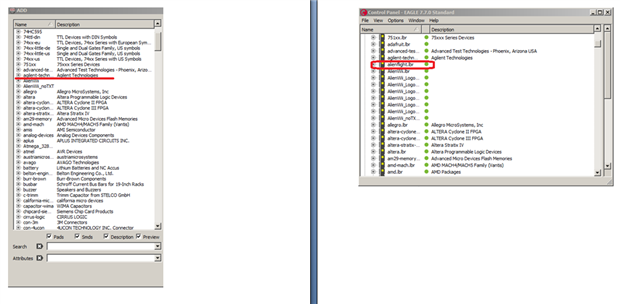

I downloaded an Eagle library and placed it into the library folder of my Eagle 7.7.0 folder on C Drive.
I opened a new schematic, went to the Library > Use in the menu and selected this new library. It was available there but when I go to add it to the schematic it is not available.
What am I missing here please, as I do this all the time with new libraries that I make or modify and do not usually have any problems. Thanks.

  • Pedro147
    0 Pedro147 over 9 years ago in reply to Pedro147
    Thanks Rachael,
    you prompted to go back and re-export that library. I had chosen the wrong option and consequently only exported the package without the symbol and device.
    Peter.

    0 Pedro147 over 9 years ago in reply to rachaelp
    Hi Rachael,
    I think that is he problem. Only the package is available not the device or symbol which is strange because I have both a sch and brd file that this library is used in. I exported the library from the brd file so I will try again.
    Well at least I now know why, but need to find out how to fix it image

  • rachaelp
    0 rachaelp over 9 years ago in reply to Pedro147
    Hi Peter,
    Does that library open up in the library editor ok? I've had a corrupted lbr before which didn't show up.

  • Pedro147
    0 Pedro147 over 9 years ago in reply to geralds
    Thanks Gerald yes I did. It is in the lib folder of Eagle on C Drive. It cab be seen in the Control Panel but not in the Add to schematic screen
  • geralds
    0 geralds over 9 years ago
    Did you activate your downloaded lbr file in the panel? - -> panel / lbr / xxxx.lbr (gray or green dot; green shows "active" )
