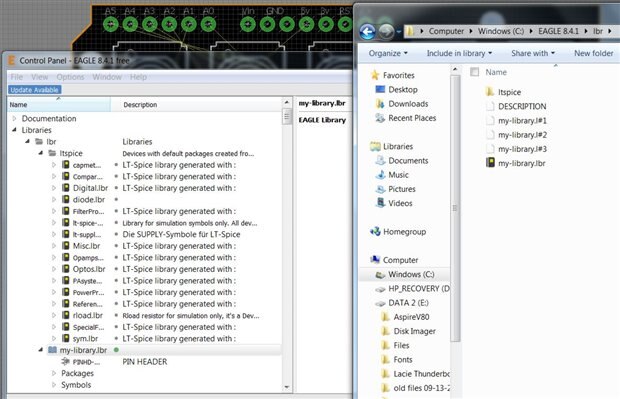

I've used Eagle extensively in the past, like version 3.5. I need to make some boards so rather than try to recover my original purchased files I just downloaded the latest version. I had a set of notes for copying a part into my library, modifying it, and saving the new part. It was never easy, but I had notes that made it easy. Now everything looks different, I can't get anywhere. I have tried several online tutorials but they are too old, or they leave out important details.
All I want to do is copy some pin headers to my library and change the pad size to a smaller size for an arduino shield I want to draw up. I can not get it to see the modified part when I add parts. I'm sure I did something wrong.

    I found it. You see, I was expecting it to show up separately as it does in the control panel window. But I found it in alphabetical order embedded in with the others. I'm still a bit lost in the library, editing of the packages. I thank you for your help and will continue to learn it.

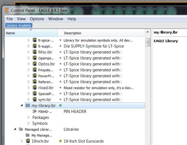

    Hi Jim,
    It looks like it's in the root of a specified folder so that's ok and it's correctly "used" as can been seen from the green dot to show the library is enabled. My guess is your library is there in the add dialog but you aren't seeing what you want because you are trying to add in the board and it's only showing packages. Also it might not be easily found because of the huge amount of libraries which come with EAGLE can obscure things and make them hard to see/find.
    So try the following:
    USE -*;
    USE my-library;
    Now when you click on the add button you should see a list which contains ONLY your library. If you still can't find what you are looking for then, show me a screen capture of the add dialog box with your library expanded out to show what you see in there.

    This is how it is set up. Is it correct?
    I have always just jumped right into making a simple board for small projects. I figured I could complete the schematic at a later time if I wanted. Is this not the case?

    Hi Jim,
    I'm wondering if your new library isn't in the library paths specified in Options->Directories in the EAGLE control panel? Remember that EAGLE will not recursively follow sub-directories so if it's not in an explicitly defined directory it will not be seen. Also, if you are trying to add a part from the board, you'll only see packages and not the actual devices.
    Also, when you do get the pin header into your board, make sure the pad sizes reflect what you are actually expecting. If not then it's likely due to the restring setting in the DRC but we'll worry about that if it turns out to be an issue when you get to that point.

  • veryfungi
    0 veryfungi over 8 years ago in reply to rachaelp
    Hello Rachael,
    Yes, that is in fact what I have done. But when I add a part to the board "my library" does not show up. As you can see in the image the part does not look like the others. Can you tell me why "my library" does not show up when adding parts? Thanks
