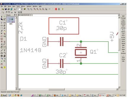

Hello all,
I have a design that I had to pack in good and tight and as such I have deleted (not just turned off the layer) the component values and part numbers.
I now have more space on the board so I would like them back  Is there a way to undelete this information?
Many thanks
Mike

    or you can use command "info", uncheck the "Smashed" in schematic or layout editor. then these "deleted" name and valuese can be back .
    I think eagle should povide a button for "un-smash".

    just to add on, so if you would like to have your Name and Value back, try to unSmash (Right Click on the symbol, choose properties and unchecked Smashed) the symbol that you have worked on previously.

    Hi Michael,
    as you can see, using Smash function, you can manoeuvre the Name and Value (Show in red Box) according to the position you desired without affecting the position of the symbol.

    There might be an easier way, but unsmashing the component gets it back (albeit at the default size, rotation and offset).
