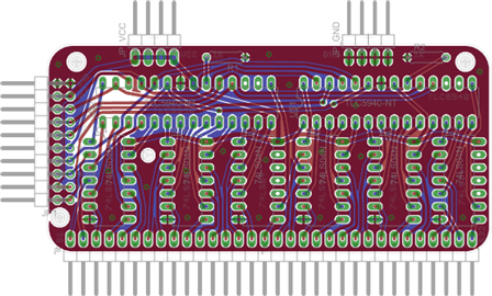

    0 e14 Contributor over 16 years ago in reply to Richard_H
    Can do, though you need to be aware that it really has strong limitations: 2 layers. Wires only (straight lines and arcs). No part placement. No via parameters. Reads only so-and-so-many lines in the SES file. And so on, and so forth. All of these should be pretty easy to fix if someone is really interested in it.
    Here's a PWM board for LEDs that I routed in Topor (manually; push-and-shove is gold!!), after re-import in Eagle:
