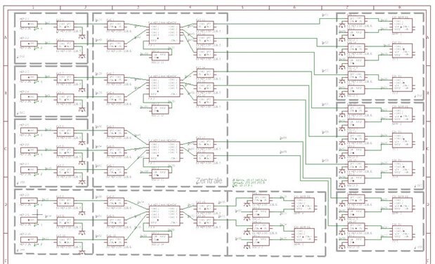

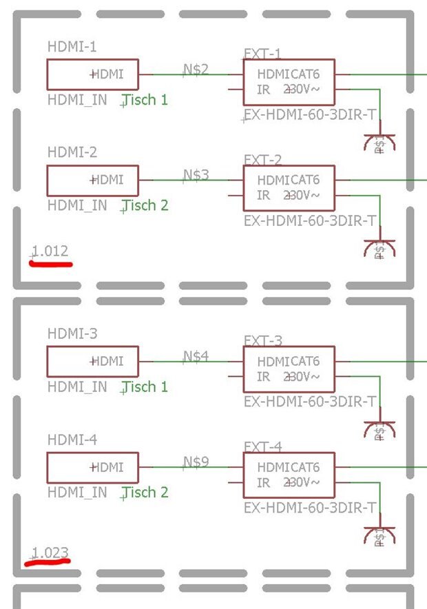

Hello,
is it possible to draw a rectangle with a given name?
And all parts, which are inside this rectangle, I need in ULP.
Example:
I draw HDMI and LAN connections with Eagle. The parts should be placed in "rooms". In the example "1.012 and 1.023.
Now i need in ULP for each part the "room" name.
EXT-1 is in room 1.012 (for example)
So how can I draw areas/rectangles/... which I can check via ULP, which parts are inside?
Have someone an idea?
Thank you!

    Ok, how are your bounding boxes drawn? Nets with a long dash line style and a thick width? If so how about you give them net names to match the rooms then use the ULP to get the X and Y bounding extents of each room and then compare the X and Y location of each component in the room with those extents to work out which room they are in?
    Best Regards,
    Rachael
  • fohnbit
    fohnbit over 8 years ago in reply to rachaelp
    Hello,
    yes, I guess this will be the best option.
    But can´t find the "Position" values in ULP.
    With UL_DEVICE I have area ... but not a position of the part
  • rachaelp
    rachaelp over 8 years ago in reply to fohnbit
    Look at UL_INSTANCE. You should be able to loop through all the instances of parts to find all the x/y positions and assign them to rooms.
  • fohnbit
    Thanks, it works!
