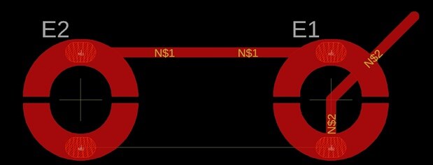

After following these guides I placed my part on a board. However I cannot route to the custom smd pads.  I repeated the process with unmodified smds, but I still can't route to the custom library part. Based on this, I'm guessed that whatever it is that I am doing wrong is covered in the Library Basics tutorials. However, I have started fresh twice following the tutorials but I still can't get it to work. I also followed the tutorials and made the same part as in the tutorials but I can't route to the tutorial part.
It looks like I am not allowed to attach the library file, so I will briefly describe what I did for my custom smd (omitting some details).
     First, I made the footprint by placing two smds on the top layer with the smallest default size from the size drop down menu. I renamed the smds with numbers 1 and 2. Now for the custom smd, I made two arcs in the top layer. Each arc completely covered 1 smd. The arcs do not overlap each other. I then made two more sets of arcs for tstop and tcream. Finally, I made name and value placeholders in the appropriate layers. From there I made the symbol and device making sure to connect the pins and pads.
I have attached an image of what the part looks like when placed it on a board (there are 2 parts in this image).
Thanks,
Randy
Message was edited by: Randy Gaillard

    I see the custom pads are showing DRC errors from the Live DRC. I'm assuming you are using walkaround routing mode in which case the reason you cannot route into these pads is because in walkaround mode you cannot violate DRC, it will not let you. You need to look at why it's throwing a DRC error and fix it or change the routing mode to the non-walkaround variant to allow you to route these in manually.

    Thanks for the reply Rachael.
    I do get overlap errors, but I'm not sure what to make of that. My understanding is that Eagle should consider the custom pads to be an extension of the initially placed smds as long as the initial smds are completely covered by my custom shapes.
    When I use the part that I made from the Library Basics tutorials, I don't get any DRC errors, but I still can't route to the pads for that part.
    Thoughts?

    WarrenBrayshaw over 8 years ago in reply to rgaillard
    Hi Randy
    Your part is named "echo_electrode_arc_1mm_200um"
    If this is a spark gap and it's meant to have a 200um gap, it appears to have only a 100um gap
    Also a spark gap should not have solder stop in the gap so the footprint would need updating.
    I tried making the two arcs out of two arcs each and place the smd at the join. That worked out well and the part can exist on the board with no DRC errors.
    I've attached my effort but do check sizes etc. before you use it as it is a bit different to yours. The gap is 200um the circle is on the documentation layer. You can delete that.
    Inspect the package parts in the package editor of the library to understand whats been  done.
    Try it on a board and see how it behaves. - Enjoy
    Warren

    rgaillard over 8 years ago in reply to WarrenBrayshaw
    Thanks for the reply. I did not realize that arc is treated differently than polygon. Actually, in 9.1.0 there is no polygon available when creating a footprint. The only available shapes are lines, circles, rectangles, and arcs. I've been assuming that all of these are considered as polygons.
    I have not tried autorouting, but I assumed it would potentially cause unwanted connections since I am able to do it manually when walk around obstacles is selected.
    I'll try and report back (maybe tomorrow) on what you have suggested about placing the pad at the end of an arc (or splitting the arc and placing it between the split arc). Though that may be more trouble than its worth at this point.
    HI
    You can create a board without a schematic but you do have to tell the board where the interconnections between pads are. You do this with the SIGNAL tool , on the board after ADDING the packages/elements /footprints. After that you can perform the routing.
    Turning off the thermals will likely not show any visual effects in your instance. I'm not sure but turning them off removes the possibility.
    The overlap errors are because you have not legitimately created the custom pads.  The smd needs to be on the end of a wire or surrounded by a polygon.
    The manual says the following for "Arbitrary pad shapes"
    "As soon as the center of the pad or SMD is inside the polygon's area or a wire begins at the center of a pad, it is recognized as a part of the PAD/SMD."
    You have used a wire (arc) so the smd needs to be at the end. Alas this is no good for your shape. I suspect you could split each arc and at the join of two arcs place the smd there.  Most simply you can just approve the overlap errors. The board will still be made correctly.
    tRestrict does not stop you manually routing over an area but the DRC check will show it. An autorouter is said to avoid the area.
    HTH
    Warren
    Ok this helps a lot.
    Its been several years since I have made a PCB and even longer since I've made a custom pad. I didn't remember that I needed to create a schematic before I made a board. Making a schematic first allows me to route to the parts on the board.
    I unchecked thermals under properties for both pads. Does turning of the thermals for the smds in the footprint change anything visually? Why do you suggest turning them off?
    I'm still getting DRC overlap errors. Any idea how to fix that and if overlap errors would cause a problem if I wanted to have the board made?
    Also, I added a tRestrict arc to both pads hoping that would prevent routing through the pad. tStop is already there. As you can see in the image the N$2 trace is going through the pad for N$1. Is there anything I can do to prevent this?
    Thanks for all the help everyone
    Hi again
    On the schematic, when you move the device, do the nets stay attached?
    Hopefully you are using the NET tool to create the nets and not the WIRE tool. The WIRE tool will get you into trouble and while similar to the NET tool the NET tool has more features to assure you get nets connected to pins
    I'm using  Eagle 7.7 ,After I changed the grid of the symbol editor such that the pins were on the  0.1 inch grid, I had no problems creating a schematic, adding nets and seeing airwires on the board.
    So your library is fine. A point though; you may wish to turn off the thermal tick in the package as its not useful within your custom pads.
    Hope this helps
    Warren

    rgaillard over 8 years ago in reply to rachaelp
    No I don't see any air wires and turning off walk around mode does not allow me to route to the part.
    I'm thinking that the problem must be with how I created the footprint but I'm at a loss as to where to start diagnosing the issue
