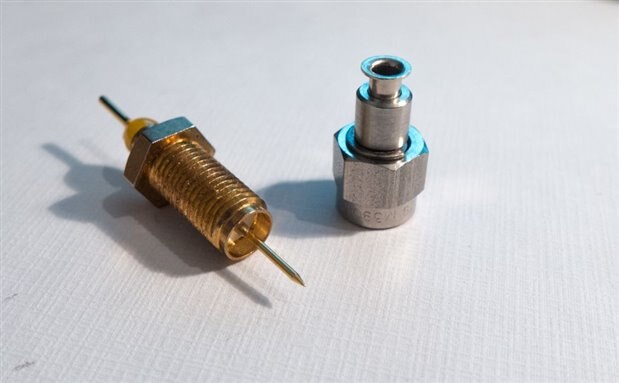

    shabaz over 10 years ago in reply to jc2048
    Hi Jon,
    Exactly as you say, it would be good to build that into a small screened handheld enclosure (the FET part, if not the entire circuit), with a cable down to the battery box/speaker/LM386.
    Basically just a tiny length of coax with solid conductor, to extend slightly away from the enclosure (a mint box, or perhaps a painted cigar tube!). The solid conductor being filed to a tip.
    Incidentally for an unrelated project I built this a while back.. severe overkill for a low-cost audio probe of course, I'm not suggesting it.
    This will have a few pF capacitance too, but I'd only intended to use it at low frequencies for some other project. The part on the right is
    just an SMA shell, to use as a cover to protect the tip when not in use.
