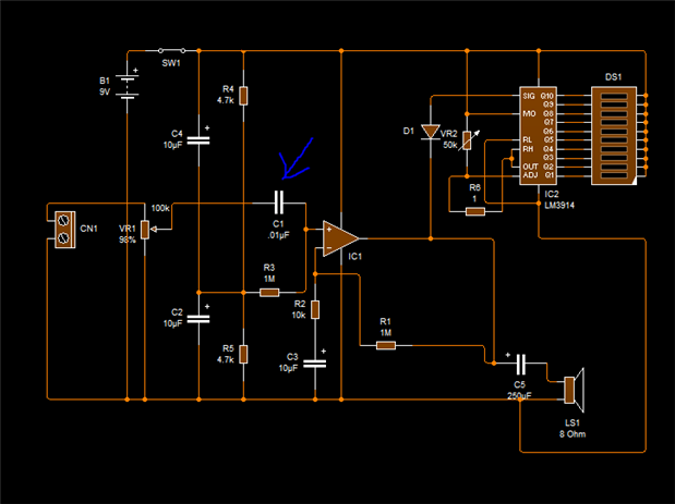

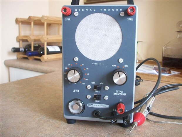

One of my projects for this year is to create a "new age" signal tracer like I used when i was a kid.
What I had was an old heathkit IT-12 pictured below.
The thing is i have no clue how this worked. I loved using it, and well just playing with it. It was sencitive efuff to hear audio runing through circuts without contacting the circuts, just getting the tip close to a trace.
So to start things off I created a audio amplifyer circut that I think is how this unit worked.
There are 2 things that I am compleetly lost about though.
  1. How to make, or what to use for the probe.
  2. How to make the visual circut.
1~I was thinking of taking a nail, and wraping copper wire around the nail to create a pickup coil, but i have no idea if this would work or if there is something better to try.
I am open to any ideas.
2~I was thinking of a 10 segment led bargraph desplay. But where would I need to conect the driver up to in the circut in the diagram? Would it be the the + side of C5?
I ordered some LM358N LM358 358 Low Power Dual Op-Amp IC's for this project that should be here on the 10th.
So I am planning on bread boarding this after that.

    jw0752 over 10 years ago +1
    Hi Lupe, This sounds like a good project if you do any audio equipment servicing. I used to use a cheap imitation of the HeathKit in the old days. In your final design you are going to want a higher impedance…

         This sounds like a good project if you do any audio equipment servicing. I used to use a cheap imitation of the HeathKit in the old days. In your final design you are going to want a higher impedance input. The schematic you display has the resistance of the volume control as a load on your input. I think you will want a small capacitor in series with the input. If I was going to make a probe for one of these I think I would use a regular meter test probe and put a coax cable on it. At the probe I would expand the shielding over the handle of the probe and then cover it with heat shrink. This would keep interference down and give a good point with which to touch the circuit traces. With a capacitor in series you will not have to worry about touching a voltage rail. I have seen small bar displays that give a basic voltage level reading. You can drive the output of your amplifier into a voltage integrator and use the bar graph to read the voltage. You should be able to find some circuit suggestion if you google VU meter circuits. I look forward to seeing what you come up with.
         I use to see those indicator tubes, like the one on the Heath Kit, on some of the old radios that I used to play with. As the signal got stronger the green light of the display would close down. It was very cool.

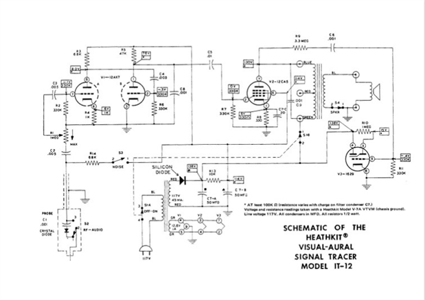

    Hi Lupe,
    Here is a schematic of the original unit.
    This is basically a high gain audio amplifier. The probe has a switch that drops a .001 uF cap and a diode into the circuit for the RF and bypasses the cap and diode for audio signals. There is still a cap C2 .005 uF in series with the input potentiometer. There is quite a bit of information on the web about this little tracer and they are selling on e-bay for over $100.00. Not bad considering they originally sold for $20.00.

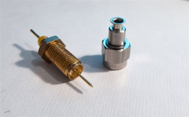

    For the probe, a very expensive (but nice) option is a Pomona case - they have one which is aluminium and a useful size for a probe. I can try to dig out a part number if you require it. However I probably will go for a sweets/candy enclosure,
    something like a very small tin of mints for the high impedance input amplifier, and a cable to the rest of it (speaker/battery).
    For the pointy tip, filed steel could be used, but (again) Pomona sell a nice probe accessories kit that contains about five sharp tips, so good enough for 5 projects. It needs shielding though. So the coax idea from John is very good.

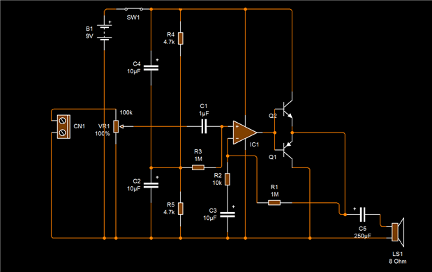

    supper_slash over 10 years ago

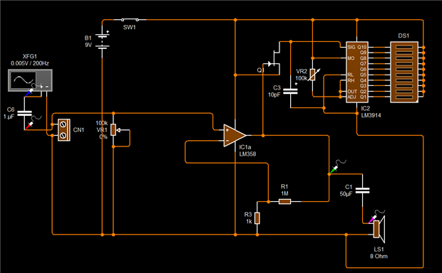

    Taking in your suggestions, here is revision 2 of the circuit.
    @John Wiltrout I was thinking the highlighted cap (C1) would provide the higher impedance needed. Am I thinking wrong?
    I love the idea of the probe, that will be the way to go.  Thank you for the  schematic, I am afraid I am not fluent with the tubes, however. image
    I am focusing on solid state, for now, I would like to move into the vacuum tubes later, I love the vintage tube amplifiers.
    @shabaz
    I pulled the transistors off of the circuit, and plan to see if that can, in fact, drive a speaker/headphones. I have a feeling I will need something to drive them, so I am thinking of adding some fets like you mentioned in place of the PNP/NPN's.
    I like the input you have on this, do you have any posts or schematics of you circuits posted? or that you can share? Maby we can work together.?  image
    Just a thought.
    By the way, the led bar is added to the circuit.image
    jw0752 over 10 years ago in reply to supper_slash
    Hi Lupe,
    When one talks about input impedance one is referring to the impedance looking into the input of the circuit. If I look into the input of your circuit I see the resistance of VR1. Look at the tube schematic and you will see if we look into the input we see the impedance of C2 at the least and if the RF switch is on we have the impedance of C1 and C2 in series. At least at low frequencies the capacitors have much higher impedance than the VR1. Don't worry too much about tube technology. I strongly suspect that it isn't coming back. I have been waiting with my tube manual in hand for 50 years. Good luck on your project.

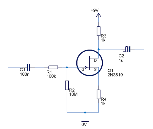

    shabaz over 10 years ago in reply to supper_slash
    Hi Lupe,
    My circuit uses a surface-mount-only part, and isn't ready for prime-time, but as an alternative I drew up the circuit below - uses through-hole parts.
    It would be the high impedance input stage, so you could attach the right side of it to your LM358, or a LM386 circuit.
    Any popular N-ch JFET could be tried any of these are common  2N38192N3819 2N5486 J310
    It has a very high input impedance (of the order of Mohms). It will distort and clip perhaps above a few volts input, but that's ok
    (doesn't matter for your application). It will need a screened box.
    I have not built this circuit but it should function(played around with the  2N38192N3819 a lot in the past : )

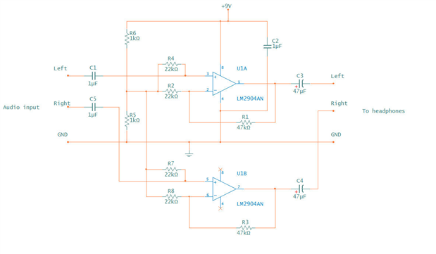

    For the speaker stage, I personally really like the LM386, it is a fine audio amp for such test applications, but if you want to use the LM358, then here is a known working circuit
    that I built up a while ago as a quick test amp for some circuit (it is not hi-fi). It uses the dual op amp version of the '358 (LM2904)  for stereo but you only need one channel of
    course so could be replaced with the '358 (the pin numbers will be different).
    You don't need the input capacitor drawn below since the JFET circuit above already has that.
    This circuit was tested with headphones (and it was loud), not a speaker, but it should be ok-ish with a 64-ohm speaker - that needs testing though!
  • supper_slash
    supper_slash over 10 years ago in reply to shabaz
    Very good ideas. I have incorporated it and updated the schematic.
    Hoping to have something on a breadboard, and prototype by the end of the month.
    Using a 358, I have on hand to see how it goes.
    I added C6, that will be in the probe, and I may need to add a diode, but if I do it will be switchable.

  • jc2048
    jc2048 over 10 years ago in reply to supper_slash
    I think you've simplified your circuit too much.
    The artificial ground (potential divider and cap) and the dc blocking capacitor on the gain resistors were necessary.
    The input potentiometer doesn't do anything very useful the way you've connected it.
    Are you using a simulator that tells you that the circuit you've drawn works ok?
