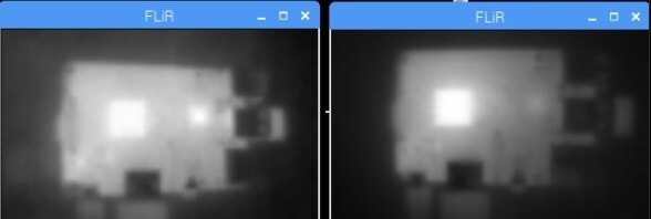

    0 the48sicks over 8 years ago
    Not used the Panasonic thermal imaging device but i have a FLiR Lepton (version 1)
    The more recent Lepton modules will actually report the degree rating behind each pixel but mine isnt so flashy
    On the left is a raspberry pi, busy downloading a load of updates so you can see the usb LAN chip nice and warm. Image on the right is a little later compiling OpenCV
    For your project you might need a thermal image sensor thats a little more substantial
    hope this helps!
    Matt
