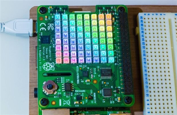

Since the Sense HAT has 64 LEDs, I wanted to try them together : )

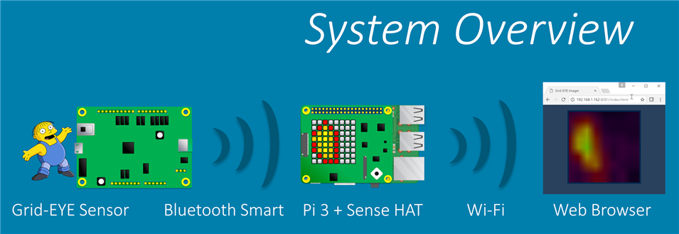

This is what is implemented:

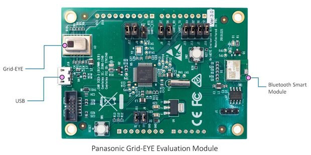

The evaluation board contains the Grid-EYE, a pre-programmed microcontroller and Bluetooth Smart capability. Basically nothing needs to be done with the eval board except plug it into a power supply! The supply can be a 5V mobile phone charger or a PC USB port. The photo here shows the Grid-EYE evaluation board. It is about the footprint of a playing card. The Grid-EYE module itself is very small, about 12mm on its longest dimension.
Since the Pi 3 also has Bluetooth Smart capability, the Grid-EYE board connects to the Pi using this. This is great because it means that the imaging can be performed remotely.
The Pi 3 is responsible for translating the 8x8 array of values into colours and sending them to the Sense HAT’s display. The Pi 3 also runs a little web server so any web browser (e.g. PC or mobile phone) can be used to connect to the Pi and view the images live.
