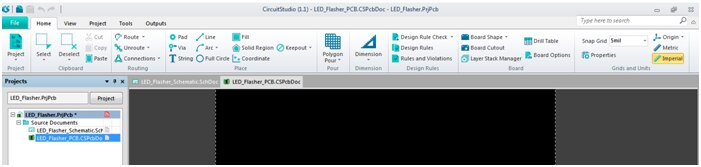

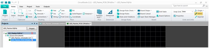

Open up the project (well, if it’s not open already..) and click on “Project” → “Add new PCB”. This generates a blank PCB document with a default file name. Go ahead and give it a name. I like to keep it coherent with my schematic file name, so I’m going to name this “LED_Flasher_PCB”.
The next thing to do is to set the Grid size and units on the far right of the ribbon. The default uses Imperial system of measurement, I’m going to use the Metric and set snap grid size to 5mm. Also note, it helps to set the Origin to the (0, 0) if that is not the default origin already. This might be a little tricky to move the mouse to the exact position, but should come with a little practice. Once you set the Origin, click on “Absolute Origin” to move the origin of the board.
Now type 5mm into the Snap Grid box and hit return. Your blank PCB document should change as follows:

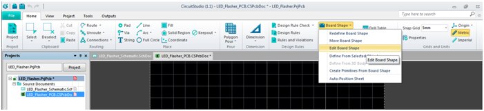

The next thing to do is to set the board shape. Navigate to Board → Edit Board Shape and your blank PCB should now be editable for shape as shown below.
Go ahead and make the PCB’s shape as you like, but for the purposes of this blog, I’ll keep it at the default shape. You can see in the screenshot below that I’ve gone ahead to create a star shape. But, I’ll reset it back to the default to proceed further. When you are done, hit Save.

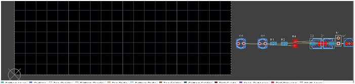

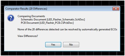

Now, it’s time to import the schematics into the PCB. Navigate to Project → Update Schematics in LED_Flasher, this brings up a dialog box showing the recent changes (if any). If there are any last minute changes in the schematic, you can cross check them here before starting to create the PCB. Once you are happy with the changes, click on “Close” to close the window showing you the changes.

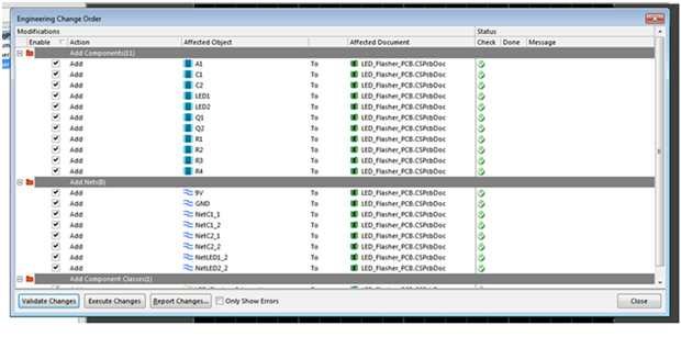

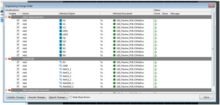

Time to import the schematic into the PCB. Navigate to Project →Import changes to bring the components into the PCB. You will see an “Engineering Change Order” generated. This is how Circuit Studio handles changes between schematic and PCB.
Click on “Validate Changes” to check for any errors and once it’s done, you should have green ticks under the Status column to indicate validity of execution of all the changes. Then click on “Execute Changes” to execute the changes (duh!!). Anyways, once that is done, you should have your components imported into the PCB as shown below.
Drag these one by one into the PCB document and feel free to place them as you like. Once you are done, hit Save.

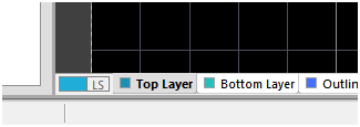

You can also view the configuration of your board by clicking on the Layer Select (LS) at the bottom of the editor window. A configuration window opens up giving you the options to change layer colours, silkscreen layers, signal layers etc.
Navigate to the “View Options” tab here and make sure theNet Names on Tracks Display is set to “Single and Centered” and also the “Show Pads Nets” options is ticked. Click on “Apply” then “OK”.

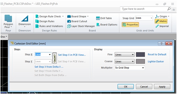

You can also change the grid size at this point depending on the placement you need. This is done from the Properties button under the Grids and Units group. I’ve set mine to step 1mm in X and a multiplier of 5x Grid as shown below. Click on “Apply” then “OK”.

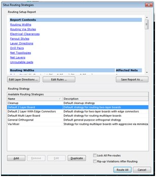

It’s time to auto-route. You can also do this manually defining all the track angles, clearances etc, but for the purpose and scope of this blog, to keep it quick, I’ll use the auto-router. Go to the “Tools” menu and click on “Autoroute” and then select “All..”. The “Situs Routing Strategies” window should show up as below. Click “Route All” at the bottom of this window. The routing should start and within a few minutes completed with a message box showing the status. This is shown in the screenshot below.
At this stage, if you are happy with the autorouting, then great. If not, you can go ahead and make any changes you like and save the project when you are done. Double clicking on a track brings up it’s properties and you can edit them here. You can also change the design rules and auto route again. Double clicking on a component brings up it’s properties which can also be edited. Feel free to play around with the various options here and work your way through your design.
