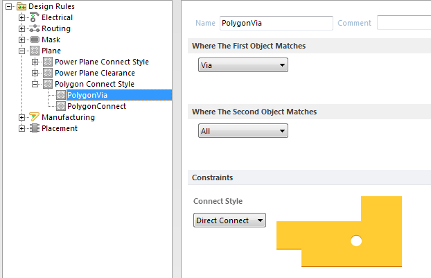

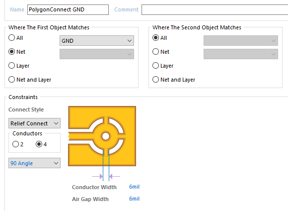

I often need to change the connection of a polygon depending on what connecting to - for instance, often want direct for vias but X on smt pads. Can this be done in CS? I don't see a way to configure rule for anything other than net, no option for setting what its connecting to.

    Check the design rules under Plane > Polygon Connect Style > Polygon Connect.

    The answer to this question using the built in CS tools is no.  Altium have removed some of the query stuff necessary from AD.  They made a mess of this in my opinion.
    However, given this is tool I bought and use, I needed to find a way.  So I manually edit rules outside of CS and re-import them, as the backend is still the same as AD and still works the same way.  See my question over at the eevblog forum for how I do it:
    http://www.eevblog.com/forum/altium/polygon-pour-connection-for-vias/
    As an example, below is the contents of the exported and modified .RUL file for no relief on vias, but relief on everything else:
    SELECTION=FALSE|LAYER=TOP|LOCKED=FALSE|POLYGONOUTLINE=FALSE|USERROUTED=TRUE|UNIONINDEX=0|RULEKIND=PolygonConnect|NETSCOPE=AnyNet|LAYERKIND=SameLayer|SCOPE1EXPRESSION=IsVia|SCOPE2EXPRESSION=All|NAME=PolygonConnect_Via|ENABLED=TRUE|PRIORITY=1|COMMENT= |UNIQUEID=YEEDPGAH|DEFINEDBYLOGICALDOCUMENT=FALSE|CONNECTSTYLE=Direct|RELIEFCONDUCTORWIDTH=10mil|RELIEFENTRIES=4|POLYGONRELIEFANGLE=90 Angle|AIRGAPWIDTH=10mil¶
    SELECTION=FALSE|LAYER=TOP|LOCKED=FALSE|POLYGONOUTLINE=FALSE|USERROUTED=TRUE|UNIONINDEX=0|RULEKIND=PolygonConnect|NETSCOPE=AnyNet|LAYERKIND=SameLayer|SCOPE1EXPRESSION=All|SCOPE2EXPRESSION=All|NAME=PolygonConnect_all|ENABLED=TRUE|PRIORITY=2|COMMENT= |UNIQUEID=IPIHNEGD|DEFINEDBYLOGICALDOCUMENT=FALSE|CONNECTSTYLE=Relief|RELIEFCONDUCTORWIDTH=10mil|RELIEFENTRIES=4|POLYGONRELIEFANGLE=45 Angle|AIRGAPWIDTH=10mil¶

    You can make Circuit Studio connect a via to a polygon pour directly and have thermal reliefs for your other pads. It takes a bit of effort though. I made a tutorial here: http://www.eevblog.com/forum/circuit-studio/how-to-selective-thermal-relief-for-vias-and-pads/

    Thank You Thank You Thank You for explaining design rules to me.  Transitioning from Altium to CircuitStudio has been a little frustrating but now that I understand CircuitStudio is Altium and I just need to use the workarounds, everything is still possible.  I love the interface of CS better than Altium but I don't like all of the items that have been removed.  This discussion has been a huge help.
    I used to use the command IsVia in Altium while declaring polygon connect rules and for CS I have two methods of relief-connects and direct-connects using polygon pours.
    1-Declare everything as a direct-connect unless it is a component.  Priority is key.
    2-Export the Rules, edit them and Import them back in.  Unless you know how to use Altium, this can be difficult.
    If someone else is looking for this, I hope that they find it.  I had difficulty searching through the forums.
  • lamabrew
    0 lamabrew over 8 years ago in reply to e14 Contributor
    For anyone else that comes across this, in 1.4 you can now select vias for the match. I did it like this, YMMV.
