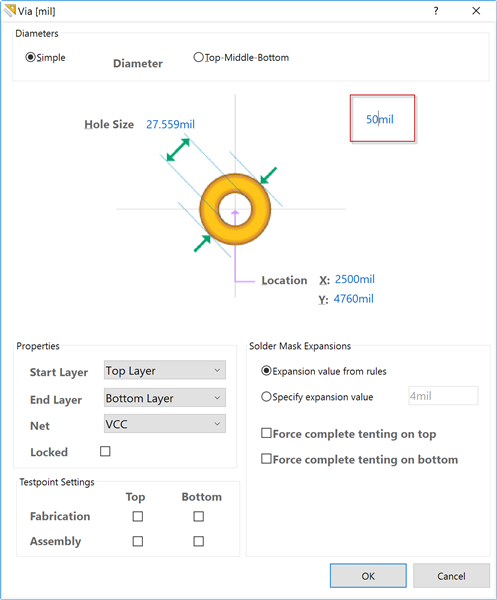

I am creating a footprint.  I want to place a hole in the board but I don't want it to be plated.  I am placing a via and there is not an option to place unplated vias.  If I place a pad then it gives me the option.  But then I must connect it to a net designator.  Is there an option that I am not seeing?  Just to place an unplated via?
Using version 1.4 of CS.

    Great question. Double click the via and you will see something like this:
    It's clear to see the hole size, but that second number that I've highlighted in red is the annular ring. For some reason on my 4k display the display has a bug, maybe yours does too. Anyway, the annular ring and hole size set to the same number produces a non-plated via.

    Interesting, I tried what you've written and it did work for me on v1.4.
    No matter what I set the via diameter to (even 0mm) it still shows up in the list of plated holes in the NC drill file, and hence a manufacturer would plate it.  It wont have any copper around it, but the hole itself will be plated.
    I know it's being picky, but that field on the right is "diameter" which is of the whole via, not the annular radius which is usually quoted as the width of the remaining copper area around the hole.  I just wanted to point this out so someone new to PCB manufacture doesn't get confused looking at PCB manufacturers specs.

    Ok so I fixed it in a way.  I created the library footprint and linked it to net designator 0.  Then in the library schematic, I omit 0 and use the necessary pins to make the part (ie. 1, 2, ... n).  When the part is added to the PCB, the via is unplated.  I haven't checked the Gerber file yet so right now I am assuming that it will work.

    That'll work but to keep it even simpler, you don't need to assign a designator to a pad.
    When I need to create a hole rather than a pad I just create a pad with the relevant hole size, set the size and shape (i.e. the annular ring) to the same and leave the designator blank then it never appears in the pins list when allocating that footprint to a component.
    One other thing to note (although you might already be aware if you have a requirement for non-plated holes) is that not very many low-cost board houses offer non-plated holes. Even it you specify them they'll all be plated. Just make sure to check with your board house first before ordering.
