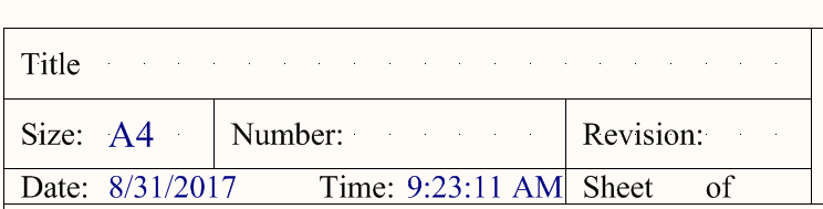

    Thank you very much for quick and detailed information how to do it. I created my own table by re-using some of the templates. One last point which you can maybe you know is how to align the text inside the table so when I move the description how to move the area where I am inserting the text from Right Click - > Document Option -> Parameters ?
    Because what I observed is if I move the descriptions for example Date: ( Black font ) and then I typed the Time from Doc Options - Parameters ( Blue ) they are misaligned. How to prevent to happen maybe you know.

    When you insert a text string (regardless of if it is using a special string such as from document parameters) you can view its properties (right click > properties) and choose the alignment and orientation.

    Thank you very much, however the problem is the following: When I open the template some of the information are available to edit but some of them like Title / Number / Revision Sheet not. When you fill the parameters in schematic they are automoatically filled the areas however I cannot edit the location in template
    See above.
    My question is: How to make visible the filed after Number: in order to adjust the position in the frame?

    If I understand correctly you will need to edit the template and place a text string, e.g. add =Title to where you want the title text to appear.

    There is actually a library of title blocks.  You can open as a schematic library and add them to your sheet or modify and make new ones. I found mine in C:\Users\Public\Documents\Altium\CS\Templates with a file name of Schematic Title Blocks.SchLib.
    This may show you examples of how to set these up.  Once placed on the sheet you can move the text strings around.  You should be able to make similar revision blocks as desired for different sheet sizes.
