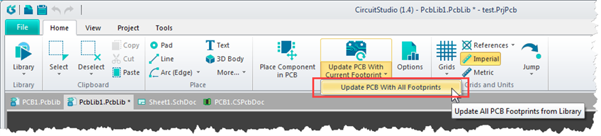

    It is possible to update all footprints from one library at a time.

    Hi Peter,
    I was actually more thinking about schematics than PCBs.
    Regardless, as I was just reminded when I hit this again after my post, "one library at a time" is unworkable as I have a number of integrated libraries, and then within those a lot of them are collections of individual components that I've pulled from various vendors and/or parts services. I'm around 30 .pcblib files at the moment. (yes I guess there's no harm in consolidated the one component per schlib/pcblib ones in to a 'common' schlib/pcblib per integrated lib, but I like the idea of keeping the files the way I get them in case there's an update).
    If I'm understanding it what you show is a "push" from the library, which means if I forgot to open a file or the converse (i.e. an older "frozen" release is opened) I would easily make a mess of things.
    What I'm looking for is some sort of right click on the PcbPrj file and select "update all components in schematics" and "update all components in layout" options.  Of course finer grain control would be much more useful, along with the ability to run a report prior to doing this to see what CS thinks the differences actually are.
