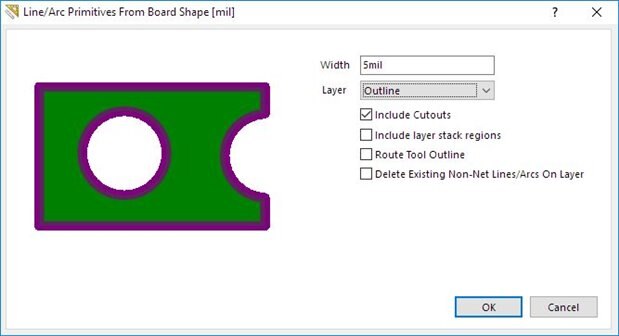

What tools outside CircuitStudio can I use to check my board outlines for correctness?
My issue: After I output my design to gerbers, zip those up, and upload to Osh Park, I get the message back that my board outline is a mere 0.04 x 0.07 inches. The board outline I set up during editing is 600x600 mils, so that shouldn't be correct. Osh Park support reports that the outline file doesn't contain the board outline at all: It only has the pad for a single resistor in it. Looking over the outline file in this online tool backs up Osh Park's assertion: I see the pad for one of the board resistors, not a board outline.
What could cause this sort of error when outputting to gerbers?

    I did later get the solution. It was easy yet counterintuitive:
    The "board shape" feature of CircuitStudio doesn't actually define the board shape! You still have to select the "Outline" layer of the board and trace over the shape you intend to draw. That's all it was.

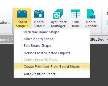

    HI Sam,
    You can use "Board Shape" ->"Create Primitives from Board Shape" then select "Outline" layer to create your board outline quickly without having to trace anything.  This comes in handy with non-rectangular boards.

    Do you know if this is the intended workflow? I found it very counter-intuitive that the board shape wasn't automatically used as the outline. It seems deceptive to have the user define a board shape and then add extra steps to actually use the shape once it's been set up.
  • bugrobotics
    0 bugrobotics over 8 years ago in reply to baudot
    Hi Sam,
    Yea, it's the intended workflow.  The options allow the user to include cutouts as well as delete random lines on the outline layer.  These are pretty important if you have some funky cutouts and/or made a mistake at 3AM while routing your board and accidentally placed a few traces on the outline layer (image).
