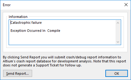

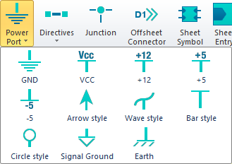

    It is a multi-sheet design - flat, not hierarchical, only 3 sheets.  I'm just using the power port objects.  I'm not trying to connect them manually, I'm just placing a power port or copying and pasting an existing one.  See the picture for typical use.  Oh, great!  Another problem... now it won't even compile without getting an exception.  It still shows the warnings/errors, so maybe it's OK or I can do a recompile.  The Net Identifier Scope is still on the default setting - I haven't changed it.  Got any ideas?

    Hi Tony. Not sure if you are saying you have copied power ports into your own parts. Normally these power ports are added directly to a design from the ribbon bar. The net name given in the property dialog for the power port is reflected in the name shown on the schematic and you should not need to name any net segment connected to such a port. If you have tried using the ports directly and still getting problems then please do consider sending through the design to software@element14.com for me to take a look at.
