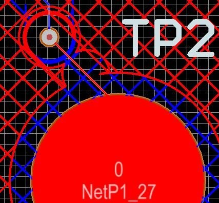

. I’m looking for help with hatched pours., I’m building a capacitive touch pcb, and need 1mm clearance around my touch pads., I’ve set the design rules accordingly. But this is what I get:
You can see that some of the hatching is actually inside the 1mm clearance. Of the 28 sensor pads I have laid out, only 1 is usable. This occurs with 45 degree and/or 90 degree hatching. I tried a solid pour, and that works fine.
Unfortunately, I must have a hatched pour.
I looked at the documentation PDFs, and the problem is there, and I also used an online gerber viewer, and verified the problem. I need to send files to our factory in China today, but I cannot send them with this problem.

    Hi Charles. Unfortunately your linked image is not displaying. A couple of ideas - increase the clearance of the polygon to ensure >1mm; use a solid pour close to the buttons and hatch to fill the remainder; are the touch areas pads - if so check if using arcs or octagons to draw around pads.

    Did the clearance change? If not then are you adjusting the correct clearance or do you have multiple rules and the wrong one is taking priority. From memory it is possible the hatched pours may draw the outline along the boundary and hence be 1/2 the line width closer than expected.

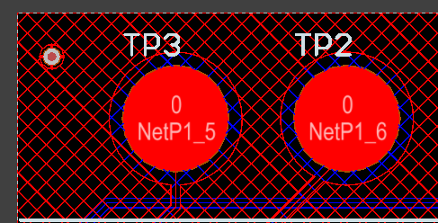

    Yes, the clearance changed as expected. The problems I am seeing are greater than just 1/2 the line width. I just tried adding a keepout around one of the pads, repoured the hatch and the hatch went crazy - much of the hatch around that pad was missing or incomplete. Hopefully you can see the image. The problem is on every pad, some worse or better than others.(the image is of the hatch problem, not the attempt with the keepout!)

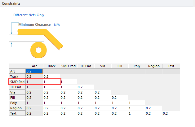

    Hi Charles. Many thanks for sending through the design - I have investigated and it appears the polygon clearance of the hatching is influenced by the clearance design rules for SMD Pad to Arc and Track and not just the polygon rules. If you adjust the values to 1mm the rogue hatching goes away.

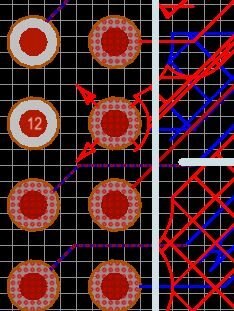

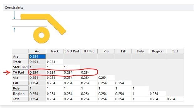

    Thank you fro reviewing my files. This work-around caused other problems however. First, the 1mm clearance violations now occur around the vias, see the image below. Next, this has caused number design rule violations around my connector, since the spacing between the connector pads is 1mm, running any trace in between becomes a violation. The settings also mean that I cannot have different clearances around my sensor pads and the traces that connect to them, which is not what I want.
  • chuckbluz
    0 chuckbluz over 8 years ago in reply to chuckbluz

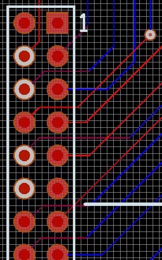

    I modified the settings as follows, and fixed the DRC errors around the connector, but the via issues remain. (I'm not using any SMD pads, so I did not change those values)

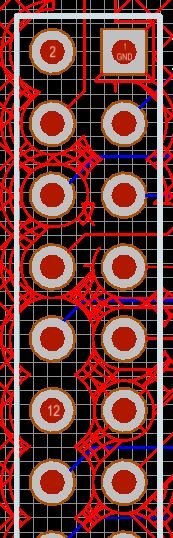

    And a final one for this morning! Not sure how this can happen, but the clearance around the through hole pads on the connector is different on different pads.
  • chuckbluz

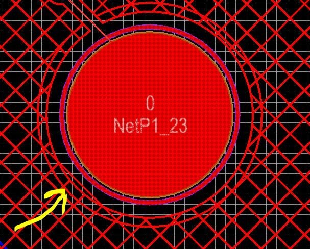

    last one, I promise - I ended up back with my original settings so I could avoid DRC errors at the connector, and also have less than 1mm clearance around traces and vias, but ended up manually adding a circular keepout around every touch sensor pad. Even so, the hatching still "wants" to fail, as some pads still have a violation of the 1mm clearance, see below. At least now the design is usable. I still consider this to be a bug, and I hope Altium fixes it.
