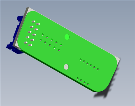

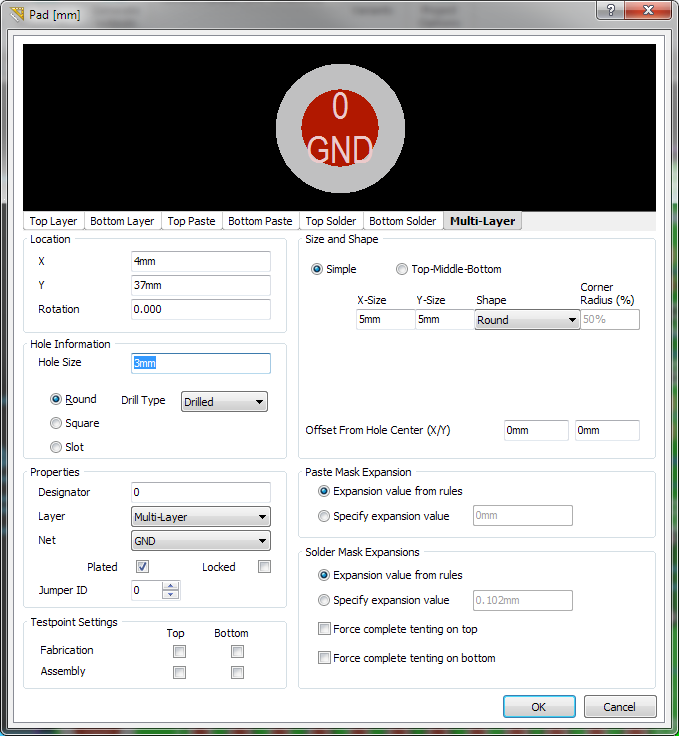

    (using 1.5) I've only done the STEP output for a small PCB that plugs in to a larger PCB so I can't say how close this it to making the STEP usable in other tools, but my pads and (mounting) holes are in the STEP file.  (more obvious from the back, which doesn't have components). If it helps here's my example.
    Here's my settings:
    and a pad example:

    Originally I had used a via hole to create a grounded hole for a stand-off + screw to go through. None of the via holes appeared in my step file when i exported it from Altium. I solved the problem by replacing the via holes with pad holes. They did appear in the step file, although it's hard to tell if it's covered by a thin solid shape (the two large holes near the center) :
