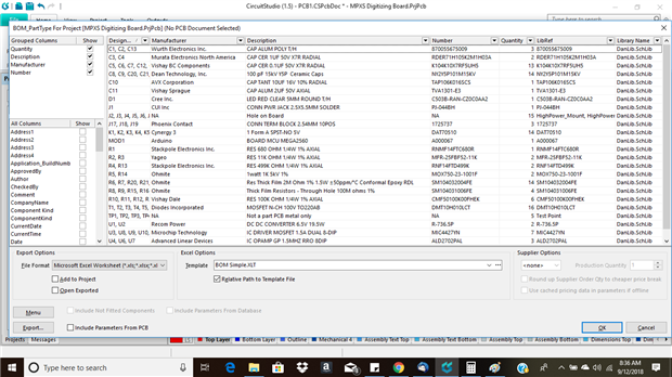

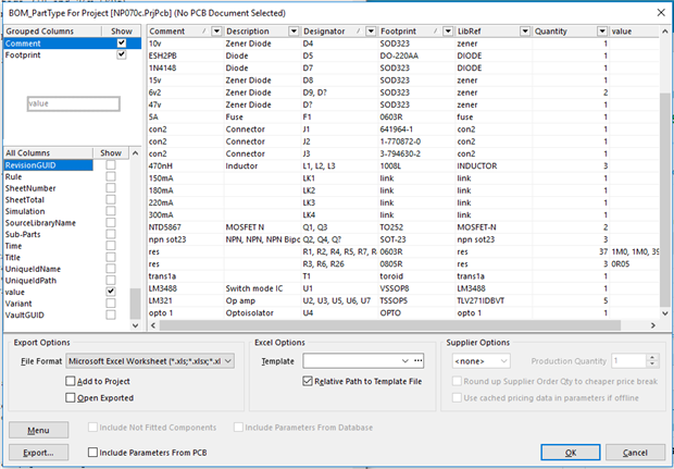

Every thing exports into the excel file but the part number of the part.   For some reason excel wont except it.  It is not importing the row and leaving an error message.   I can get the part number from library reference but I would like to know what am I doing wrong.
  • frog
    0 frog over 8 years ago
    I might be able to help with this one:  on the left of the BOM configuration window there are lists of 'grouped columns' and 'all columns'.  You'll need to find the field that contains the part number and check that the 'show' box is ticked.  You can drag the field name from 'all columns' to 'grouped columns' if you want to group components with the same part numbers.
    I hope that helps.

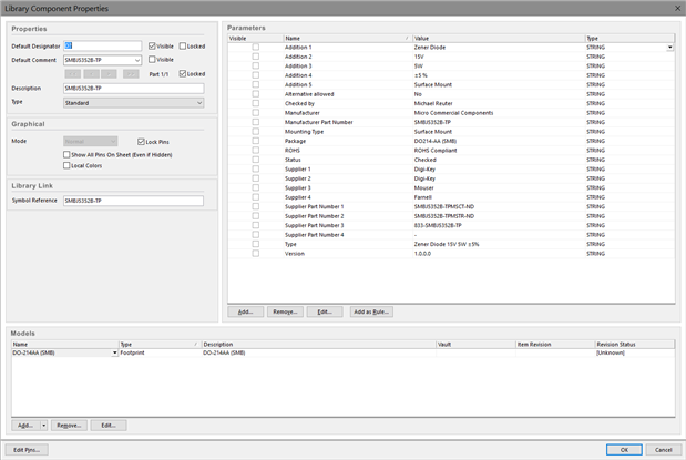

    You can create a Excel Template File so you can create automatically with some klicks a complete BOM. But before you create the BOM you must create a Component Library. Every element in my library get some parameter like this:
    • Addition 1
    • Addition 2
    • Addition 3
    • Addition 4
    • Addition 5
    • Alternative allowed
    • Checked by
    • Manufacturer
    • Manufacturer Part Number
    • Mounting Type
    • Package
    • ROHS
    • Status
    • Supplier 1
    • Supplier 2
    • Supplier 3
    • Supplier Part Number 1
    • Supplier Part Number 2
    • Supplier Part Number 3
    • Type
    • Version
    One example for a Capacitor :
    Name                               Value
    Addition 1                        10pF
    Addition 2                        ±5%
    Addition 3                        50V
    Addition 4                        C0G
    Addition 5                        Surface Mount
    Alternative allowed          No
    Manufacturer                  Kemet
    Manufacturer Part Number    C0603C100J5GACTU
    Mounting Type              Surface Mount
    Package                        0603 (Case-EIA)
    ROHS                             ROHS Compliant
    Supplier 1                        Digi-Key
    Supplier 2                        Digi-Key
    Supplier 3                        Mouser
    Supplier Part Number 1    399-1049-1-ND
    Supplier Part Number 2    399-1049-2-ND
    Supplier Part Number 3    80-C0603C100J5G
    Temperature Coefficient    C0G
    Tolerance                        ±5%
    Type                             SMD Ceramic Capacitor
    Value                             10pF
    Voltage Rated              50V

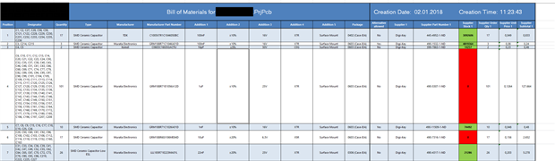

    This is my BOM:
    This is my empty BOM Template:

    0 allycat over 8 years ago in reply to frog
    Sorry Frog this was already done.   I used the word Number for the title in the parts library.   It is show up in the left corner and the column but it does not export correctly.

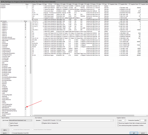

  • joedoe1979
    0 joedoe1979 over 8 years ago in reply to allycat
    All parameters you want to export must be checked. See Arrow
  • frog
    0 frog over 8 years ago in reply to joedoe1979
    But you'd think that if the heading is present in the spreadsheet then the data should be there too.  Daniel's screenshot appears to indicate that the headings are there but the content isn't.  Daniel, have you tried exporting as CSV and then inspecting the file with a text editor.
