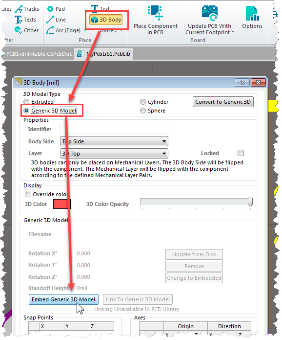

    Where can I find the 3D step models I can attach to a footprint when beeing in the tab: footprint body/embed 3D generic model?
    or that not enabled:-(
    rob
  • e14softwareuk
    0 e14softwareuk over 8 years ago in reply to rvanvreden@kpnmail.nl

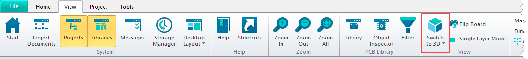

    Many library parts may already include the 3D model - you can easily check by going into 3D view mode to see what is there.
    To add your own 3D models to library parts use Home | 3D Body, select Generic 3D Model and then click the button to load a STEP model.

    Hello Peter,
    that is exactly what I do, but no stp models are there. I searched my PC for stp models, and the only ones I could find are in the GSM directory. ( and mine I made myself in my CAD program)
    So I think I dont have them.
    rob
  • e14softwareuk
    You don't get separate STEP files provided. They will either be integrated into library components or you design your own.

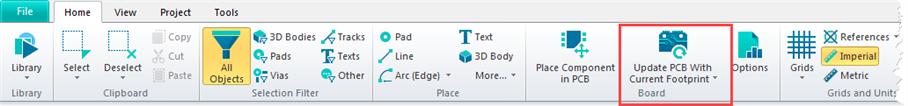

    I imported a small Eagle design in Circuit studio. worked without a glitch. I tried to change components so the 3d representation would be correct. Changing a resistor with one in the schematic to a right footprint that is 3D worked. But can not find how to update that for the PCB. How to do that?

    Hi Rob. If you have managed to update your library footprint with the 3D model then you can update your PCB design by making sure the PCB document is open and then from the library editor use Home | Update PCB With Current Footprint.
