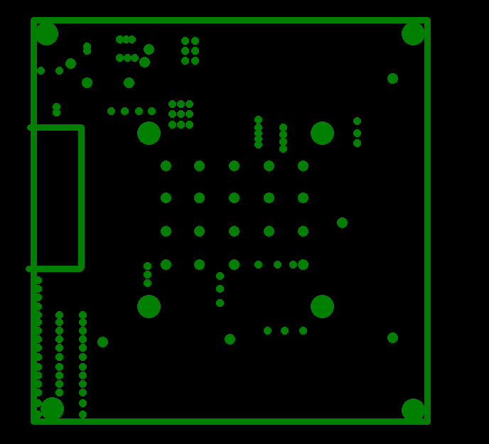

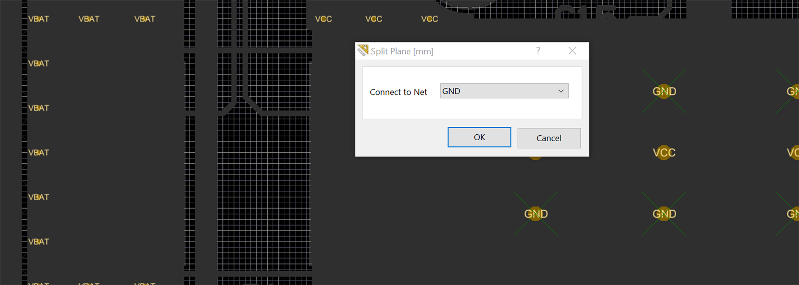

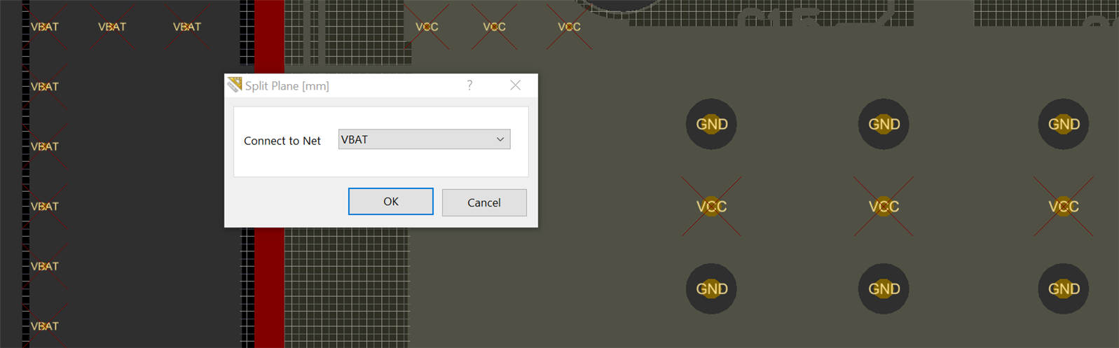

I am designing a 4 layer board - SIgnal1,GND,Vcc and Sig2. In the VCC layer I have 2 planes viz - VBAT and VCC. I have given the split using the line "L" command and drawing a 1mm thick line. The planes seem isolated and look good. Kindly refer the image below. The layer is Internal Plane 2.
The Internal Plane 1 just above it looks like -
The above is the internal Plane 1  which is GND layer. It looks fine.

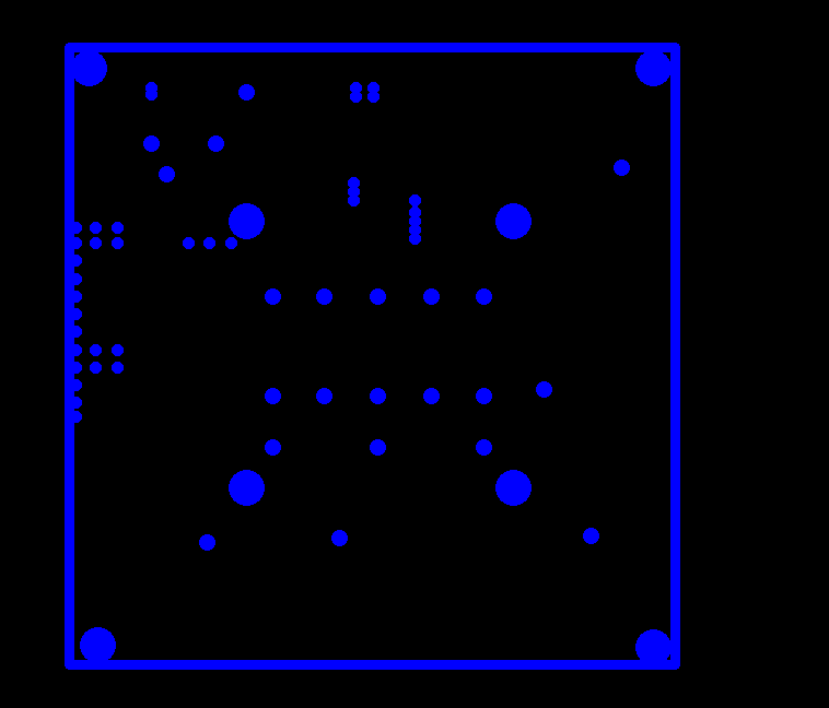

Now, I generate the Gerber files and check them on view mate -
GPI - internal plane 2 and GP1 - Internal plane 1. So, GP2 layer is as shown below -
This looks like the GND vias in my design and it also shows a split GND plane. The VCC layer is as shown below -
So, there is a complete change in the split plane. How is this so ? Also, when I select loaded preset stack-up, in 4 layer it shows all layers as routing or signal layers. No planar layers. Can you help me out ?

    There is a plane layer type in the board stack. If you open the board stack manager use the Add Layer button and select Add Internal Plane. Alternatively you can use normal signal layers and draw a couple of polygons to represent the plane areas.

    Thank you for the response. I tried the internal plane approach. But it shows the same thing. The split plane is appearing in the other layer and not the one I intend to place it on. Also, I dont want to go with the 2nd approach that you suggest for now. Have you encountered such a problem before ?
    In Altium, the preloaded stack up for 4 layer is Sig1,Lay1,Lay2,Sig2. It comes correctly so and not Sig1,SIg2,Sig3,Sig4. In the latter we are bending the system to make it a 4 layer. It will work, but if I have denser split planes and nested split planes it will be clumsy.
