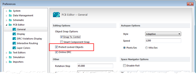

  • e14softwareuk
    0 e14softwareuk over 7 years ago in reply to sclifford
    Thanks for the video. A few suggestions to try in case you are still experiencing problems.
    1) Make sure the components on the PCB that you cannot select do not have the locked flag set. You can disable the lock flag under File > System Preferences
    2) Does setting the selection filter from Components to All Objects make any difference to the ability to select the component?
    3) Make sure that any filter selection is cleared (different to the above filter). View | Clear.
  • sclifford
    0 sclifford over 7 years ago in reply to e14softwareuk
    Peter,
    Thank you for getting back to me on this issue which has been quite the frustration getting this board done.  In my case none of the parts were locked and the selection filter was set to All Objects. As you can see in the video I can select one part but not another (Q3 & Q5).  You will also see in the video the program moved Q5 into same position under Q3 which is strange and it also was not able to be selected.  For me to fix the issue I had to delete both Q3 and Q5 from my schematic update my board then add them back to schematic and again update my board.  This fixed my issue and I was a finally able to complete the board.  I would be glad to send my design files to those at Altium to see what the real root cause of this issue is, if it would help.
