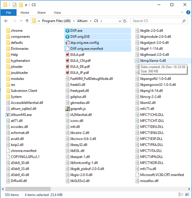

    Using this BAT as a source you will create a new DXP.exe file which is more or less an "shortcut" to the real DXP.exe file which now needs to be renamed to DXP.orig.exe
    You also need to rename the following files from:
    dxp.exe.config
    DXP.exe.manifest
    to:
    dxp.orig.exe.config
    DXP.orig.exe.manifest
    You can still run the CS as you used to but this time you do it from the renamed file: DXP.orig.exe
    If you want to run CS as a high priority process you do it from the new "shortcut" DXP.exe
    If you trust running an executable from an outside source I post here a link with the small executable that I just created through the same process just described (and also tested it). I also found and used  in this executable the CS icon.
    If you use the file in the following link, unzip it and remember also to rename the original files as mentioned above.
