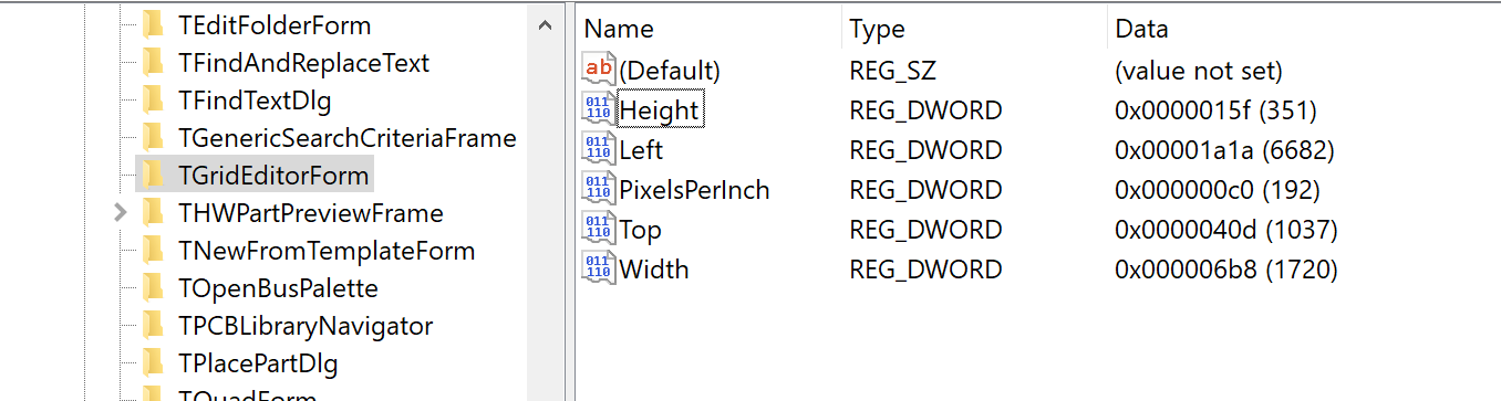

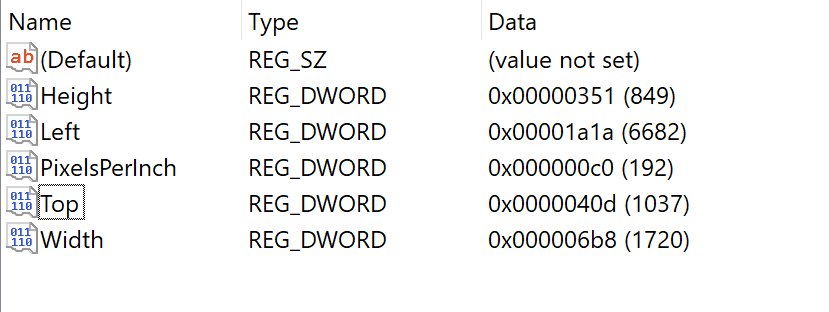

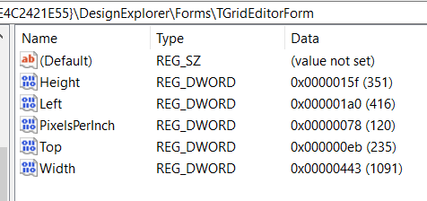

    One more thing you can try to resize the dialog, this is at your own risk as it edits the registry. Run regedit and go to Computer\HKEY_CURRENT_USER\Software\Altium\CircuitStudio {guid}\DesignExplorer\Forms\TGridEditorForm, there you will find the dialog size and position values that you can try changing. You can change with the program running and dialog closed, next time you invoke the dialog it should read the registry values.

    If you are not comfortable changing the registry, but are comfortable having a look, can you please go to the Registry key Peter referenced above and take a screenshot of the values?
    As a reference, here is how mine look for this particular form.
    I am curious if your values are somehow different, maybe an issue during install or something.  At minimum we can get a ticket submitted to make this dialog resizable, but my troubleshooting brain is curious as to the cause of this so hopefully we can get to the root of it image
