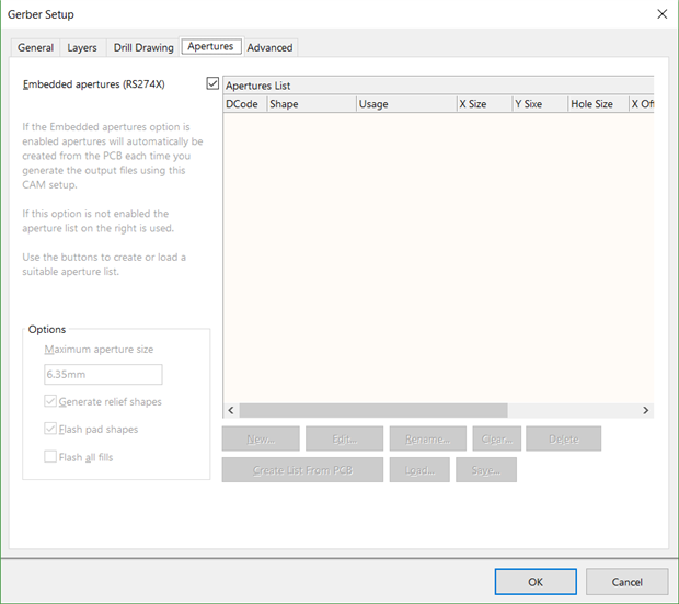

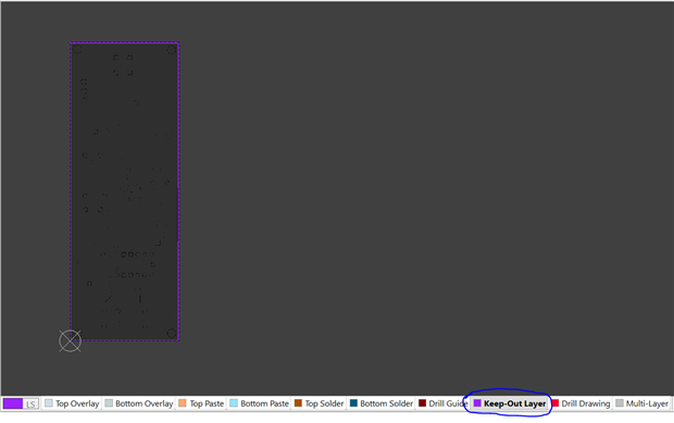

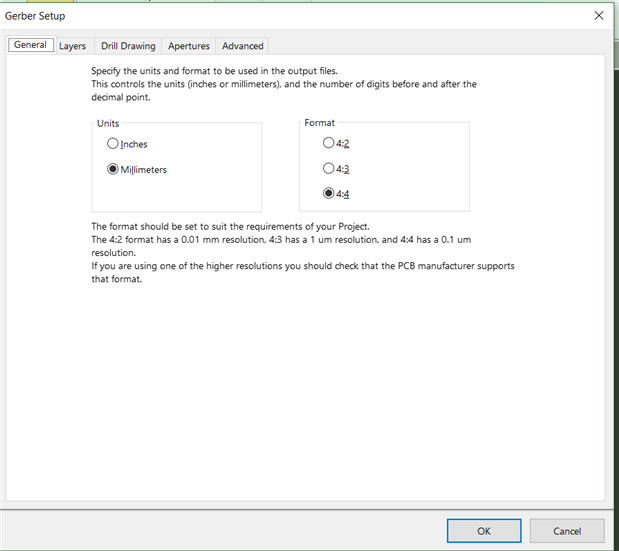

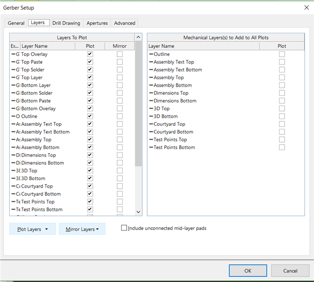

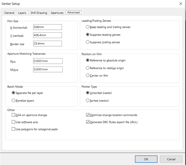

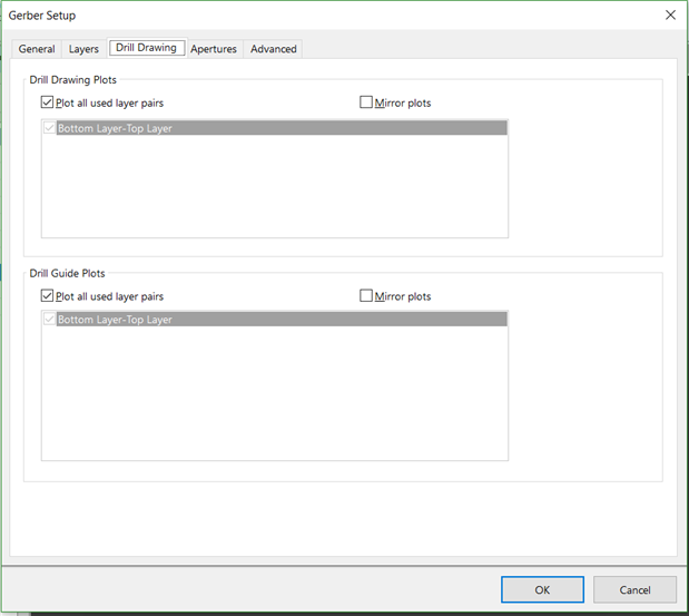

Hallo,
I do have a problem with my circuit studio. The Gerber files which are generated are mixed up. I for example i will get some Components names on my Outline file instead of the out shape of me board !!!!
I have checked my design and all layers are good in the CSPcbDoc.
  • e14softwareuk
    e14softwareuk over 8 years ago
    Hi
    If you are convinced everything is correct when viewing the PCB could you post a screenshot of your Gerber Setup : Layers dialog so that we can check the layer generation?

  • mah1990
    mah1990 over 8 years ago in reply to e14softwareuk
  • e14softwareuk
    e14softwareuk over 8 years ago in reply to mah1990
    Thanks for the images, this all looks good. Two suggestions (1) try removing/renaming the *.OutJob file in the project folder and set-up and create the Gerbers again, if that doesn't solve the problem (2) can you email me directly the PCB file so that I can take a look.

  • mah1990
    Thanks,
    you did solve the Problem.

  • e14softwareuk
    e14softwareuk over 8 years ago in reply to mars01

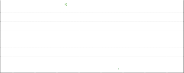

    Hi Marius, the solution was some extraneous text in the library components. To see you need to turn on the layers in the library editor.
