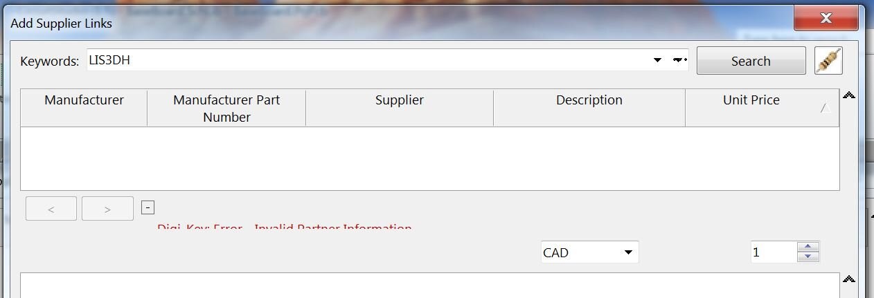

Just to let everyone know that it appears Digi-Key supplier links have stopped working with CircuitStudio, presumably due to a change at Digi-Key because there hasn't been an update to CS that I know about. I'll post a workaround/fix if one becomes available. Of course these are the element14 forums so I should really suggest using Farnell/Newark as your supplier image.
Update -- it seems the Digi-Key API used by CircuitStudio has been retired and won't be coming back. Please post below if you have been affected to give Altium some indication of the urgency with which a new software release will be required.

    What would make this bug way more bearable is if I could use the cached Digi-Key data from my design... but alas it looks like all the functionality in that corner of the BOM configuration window is not working.
    Here is a video showing what I mean:
    e14softwareuk why can't I select a supplier from this drop-down and/or why is the "use cached pricing data in parameters if offline" option greyed out?

    Hi Tom - I try my best to help wherever I can. The Digi-Key link is a good one and gives us more insight into what has happened. I would suggest anyone who uses Digi-Key posts here so that we have some idea of the impact. The more users affected the more likely Altium are to push out an update to fix the issue. Although there are many thousands of users of CircuitStudio if it only looks like half a dozen users are affected then Altium might decide an update is not that urgent image.

    Announcing that CircuitStudio 1.5.2 is now available that addresses the Digi-Key issue and adds many new suppliers.
    https://www.element14.com/community/community/manufacturers/altium/blog/2019/03/01/circuitstudio-152-hotfix-now-available
