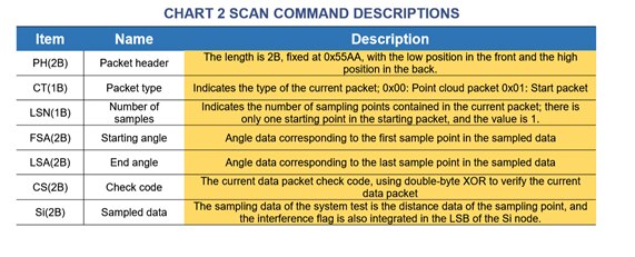

I have a data packet that states its data validation (check code) is verified by a double byte XOR.  I've Googled for a tutorial and came up empty.  I've tried to solve the puzzle in Excel to never get a match to serial data I captured with Putty.  I could use a tip on how the algorithm to apply.
The packet description is below.  Starting at position 8, the two byte CS item contains the check code and states it uses a double-byte XOR to verify the current data packet.  I've tried adding up all bytes starting at Si in series which equates to a two byte value.  I XOR it against the CS value I've assed to be xC4AD, but that didn't resolve to 0.
Should I be XORing blocks of 2 bytes and comparing to the CS value?

    But first, I found that the number of sample points was 9 bytes short in my original packet I was assessing.  The LS value says there should be 40 sample points.  So, I extracted from the stream of serial data a segment that had 80 bytes after the CS packet item.  This should be correct since each sample point is made of two bytes (80/2=40).
    In the new packet shown below, the check code is 0x0E63
    I made this routine in Excel to process the double byte XORs.  Unfortunately, it gives C7 01 or 0x01C7 in little endian format.
    Here's the algorithm:
    1. pass a comma delimited string of decimal values representing the original hex data
    2. split the string into a string array representing each byte in succession
    3. loop through the string array to create two arrays of bytes to process.  The arrays represent a left side column and a right side column to process.
    4. loop through the newly formed columns to xor each side
    5. present the answer in a message box
    I'm wondering if step 4 is where I'm not thinking right on processing it????

    Woa...I definitely didn't read down far enough.  I assumed the check code started for the sample data, but rather, its a mess of a combination with all data in the packet excluding the Check Code itself.
    This is like sudoku for me, so, I'm going to give it another couple of hours and see if I can crack it.  If I do, I'll post the code.
  • Sean_Miller
    Sean_Miller over 6 years ago in reply to Sean_Miller
    Hot Dog!  Got it.
    I have no idea why the docs have that confusing statement "since sample data is 3 bytes".  It doesn't say that its 3 bytes anywhere else in the document.  So, I didn't do anything with that.  I just dropped the check code bytes slapped on the rest of the bytes in the packet in the order they came.
    Here's a way to look at it:
    • Make two columns of bytes.  Byte 1 is row 1 left, Byte 2 in row 1 right.  Byte 3 is row 2 left, Byte 4 is Row 2 right.  On and on until the next packet starts.
    • Compound XOR each row.
    • For example, starting with decimal 170, 85 for the first block and then 249, 49 for the second as in Line 4 of the code, it looks like this in binary.  You are XORing the next row against the result of the previous XOR operation:
    1010101001010101
    XORXOR
    1111100100110001
    XORXOR
    630E
    Which is precisely the bytes at the CS item of the parameter.

    bool first_byte_received;
    bool second_byte_received;
    int incomingByte;
    void setup() {
      Serial.begin(115200);
      first_byte_received=false;
      second_byte_received=false;
    void loop() {
      // Poll for our expected 3 bytes that reflect the packet header.
      if (Serial.available()) {      // If anything comes in Serial (USB),
        incomingByte=Serial.read();
        //Serial.println(incomingByte);
        if (!first_byte_received) {
          if (incomingByte==170) first_byte_received=true;
        else if(!second_byte_received) {
          if (incomingByte==85) {
            second_byte_received=true;
          else
        else
          if (incomingByte==0) {
            ReceivePacket();
          else
    void ReceivePacket() {
      int samples_sent, starting_angle_LSB, starting_angle_MSB, end_angle_LSB, end_angle_MSB;
      int check_code_LSB, check_code_MSB;
      int left_column[50], right_column[50];
      int sample_bytes[100];
      while (!Serial.available());
      samples_sent=Serial.read();
      // Expect no more than 40 really, but just in case, just punt if more than 50.
      if (samples_sent>50) {
        return;
      starting_angle_LSB=Serial.read();
      starting_angle_MSB=Serial.read();
      end_angle_LSB=Serial.read();
      end_angle_MSB=Serial.read();
      check_code_LSB=Serial.read();
      check_code_MSB=Serial.read();
      for (int ii=0;ii<((2*samples_sent)); ii++)
        sample_bytes[ii]=Serial.read();
      // Perform checksum
      int left_checksum=0;
      int right_checksum=0;
      left_checksum=left_checksum ^ 170;
      right_checksum=right_checksum ^ 85;
      left_checksum=left_checksum ^ starting_angle_LSB;
      right_checksum=right_checksum ^ starting_angle_MSB;
      for (int ii=0; ii<((samples_sent*2)-1); ii+=2)
        left_checksum=left_checksum ^ sample_bytes[ii];
        right_checksum=right_checksum ^ sample_bytes[ii+1];
      left_checksum=left_checksum ^ 0;
      right_checksum=right_checksum ^ samples_sent;
      left_checksum=left_checksum ^ end_angle_LSB;
      right_checksum=right_checksum ^ end_angle_MSB;
      String assessment="Bad";
      if (left_checksum==check_code_LSB&&right_checksum==check_code_MSB) assessment="Good";
      Serial.println(assessment + ":  Samples Sent:  " + String(samples_sent) + " Checksum: " + String(check_code_LSB) + ", " + String(check_code_MSB) + "  New Checksum: " + String(left_checksum) + ", " + String(right_checksum) );
      while
    (Serial.available()){Serial.read();}
