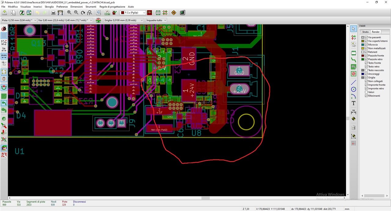

Hi , I have a problem whith  max17632c i use it for dc/dc 24v/5v  .if i put  i small load ( 100mW) the output voltage is 4,0V  , while i put a load of  2W  tthe output voltage go to 2,5V.
then i desolder  the condensator  C1 (2,2 uF 10V ceramic used for bypass ldo pin 2) and i have 5v output  whit load of 2W (the condensator  not  have problem) , Where is the prblem?

    Since it is a switching regulator, we need to see the PCB. I always suspect layout issues first with switchers. It would also be nice to see the entire schematic. Like with code, snippets rarely contain…
    It would also be nice to see the entire schematic. Like with code, snippets rarely contain the actual problem.

    0 baldengineer over 2 years ago in reply to Fabrizio70
    Are you looking at the output with an oscilloscope or a DMM?
    Remember, DMMs do not show you the full picture with a switch-mode regulator,

    whith multimeter, if i use oscilloscope i measure a ripple of 1v on pin 2 (VCC) WHITOUT C1 while whit  c1x the riplle is a some mV but the output (MEASURE ON c19)  whitl load is 2,35V
  • jc2048
    0 jc2048 over 2 years ago in reply to Fabrizio70
    It's a bit difficult to make out from your pictures, but you don't appear to have any vias for the ground pad (EP) of the converter.
    If that's the case, you could try drilling two or three holes just to the side of the part and soldering wires in place to join the two copper layers, and see if that rescues your prototype.

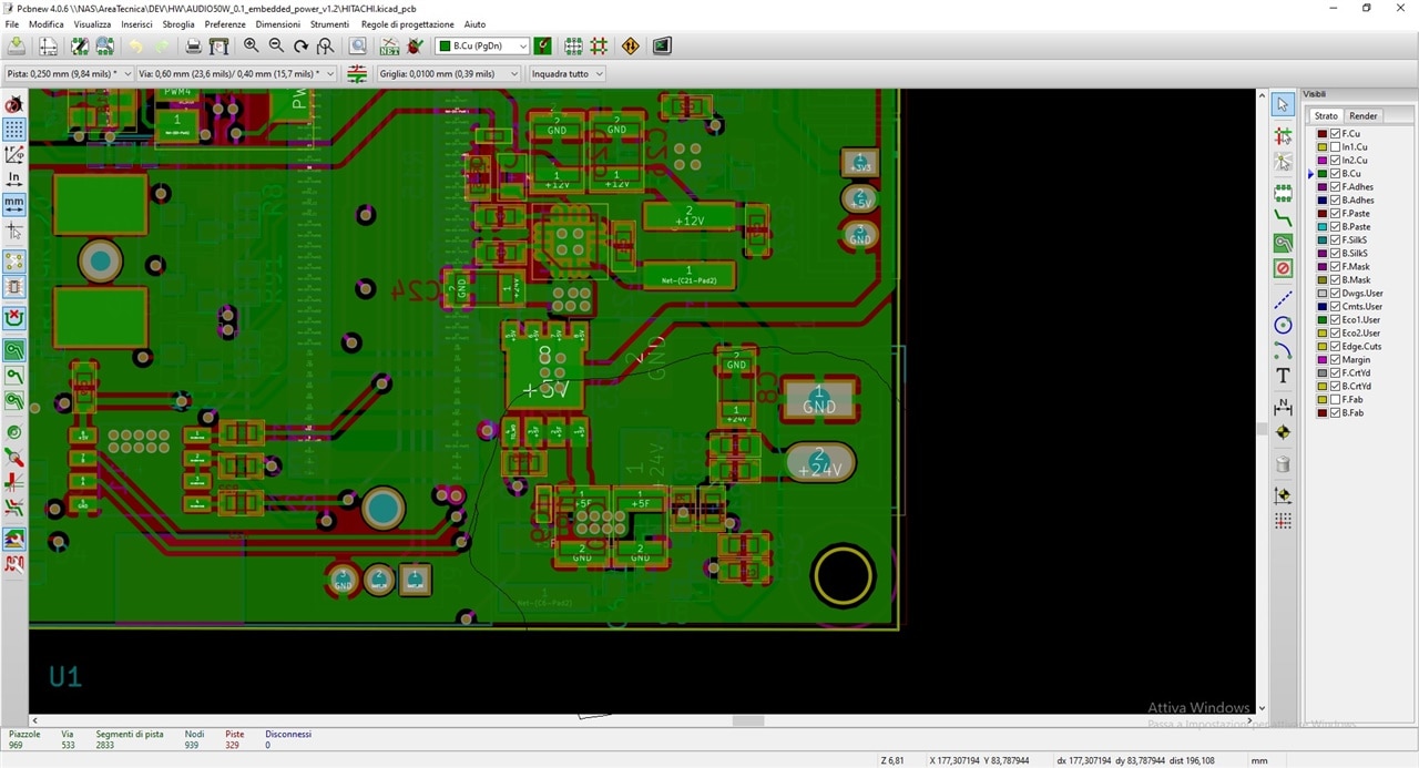

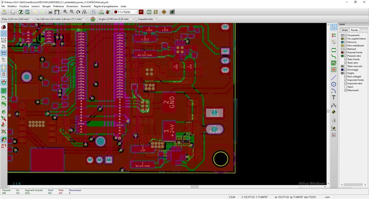

  • Fabrizio70
    0 Fabrizio70 over 2 years ago in reply to jc2048
    tank  yuo i show yuo other pics
