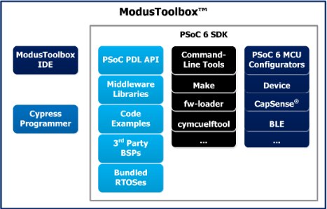

The PSoC 6 Software Library (psoc6sw-1.0) is comprised of two main pieces; Peripheral Device Library (PDL) and middleware/software libraries.
The main interface is the ModusToolbox IDE which is an Eclipse based product which means it includes the standard features of the Eclipse IDE plus some extra tools specific to the Cypress PSoC 6 devices.
The following is a partial list of some of the features available in the current release of ModusToolbox (1.0)
  • PSoC 6 digital and analog peripheral drivers, which enable rapid peripheral software development
  • The ARM Cortex Microcontroller Software Interface Standard (CMSIS) core access header files directly from the CMSIS 5.3.0 release
  • CMSIS compliant device header files, startup code (platform initialization) and device configuration header files
  • A Device Firmware Update library that can be readily integrated for any application need
  • FreeRTOS source code integrated with the PDL
  • Bluetooth Low Energy (BLE) middleware and stack library
  • PDL Application Programming Interface (API) Reference Guide

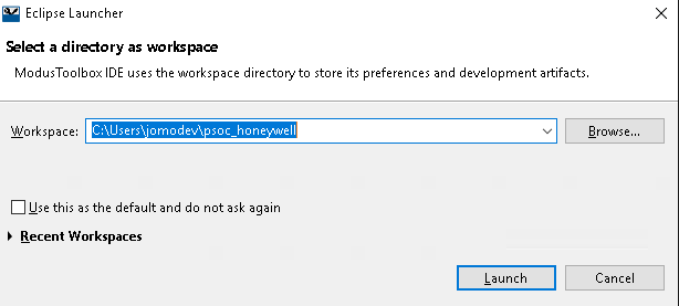

After the splash screen appears, as in a standard Eclipse IDE, the user is prompted to either open or create a workspace.

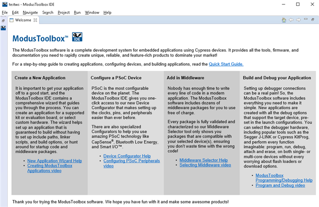

When ModusToolbox finally launches, it starts with a Welcome screen that includes links to help get started with the tool

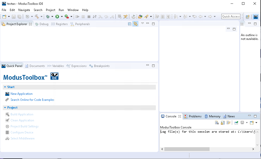

If this page is closed. then the blank IDE screen can be seen where a new project can be created or imported from an existing project.
Under the Project Explorer Pane, there is a section with the ModusToolbox IDE logo in it.  In this section, click on the Quick Panel tab and two Start options are shown; New Application and Search Online for Code Examples.

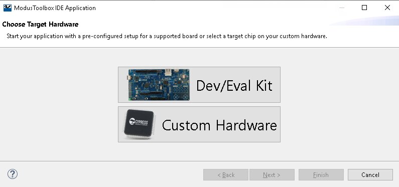

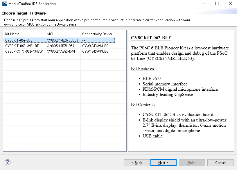

Click on New Application and a screen to Choose Target Hardware appears with an options for Dev/Eval Kit or Custom Hardware are seen.
The Custom Hardware option is for use when a new custom application is being created.  The Dev/Eval Kit option can be used to access starter examples for the supported PSoC 6 boards.
In this example, the Dev/Eval Kit option will be used.

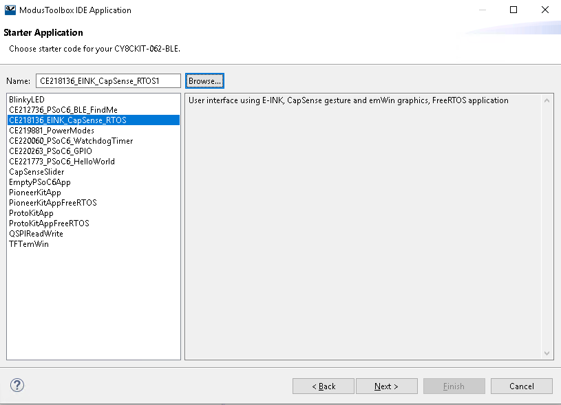

Once the Dev/Eval Kit option is selected, a screen will appear listing the supported board for ModusToolbox.
The CY8CKIT-062-BLE kit will be used in this example.   Select CY8CKIT-062-BLE from the list and click Next.

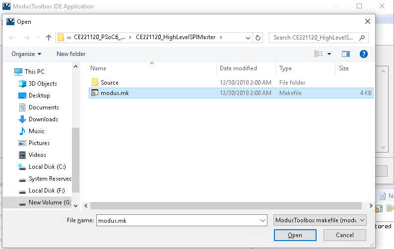

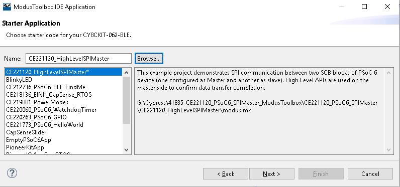

The CE221120 - PSoCRegistered 6 MCU SPI Master example is used in this post.
http://www.cypress.com/documentation/code-examples/ce221120-psoc-6-mcu-spi-master

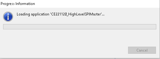

Download and unzip the file from the link and use Browse Button from the Starter Application window to select this modus.mk file and click open.
After clicking Open, the CE221120_HighLevelSPIMaster project will appear in the application selection pane.

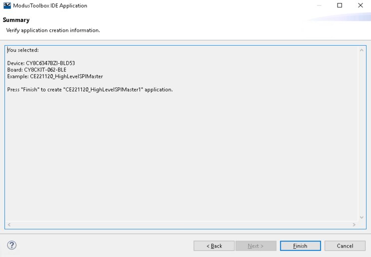

Highlight this example and click next and the Summary window will appear.
If all looks correct, click Finish and the project will be loaded into the ModusToolBox IDE

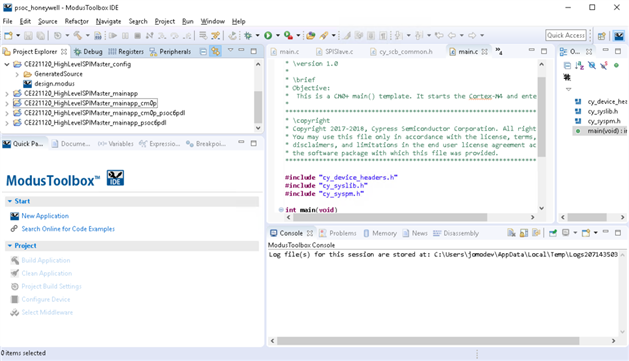

From the imported project, 5 folders are created.

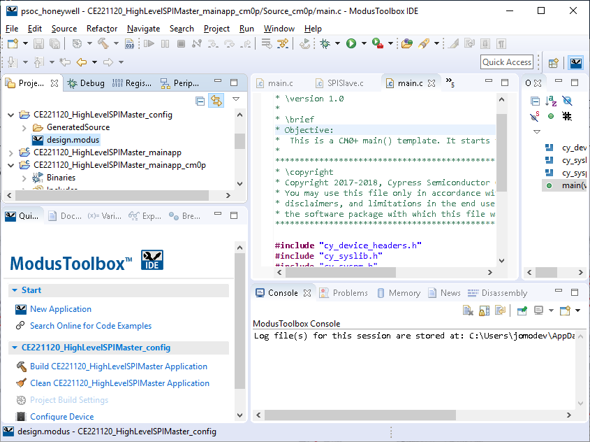

  • CE221120_HighLevelSPIMaster_config - Contains the Design Configurator file design.modus
  • CE221120_HighLevelSPIMaster_mainapp - Contains config files specific for the Cortex M4 core
  • CE221120_HighLevelSPIMaster_mainapp_cm0p - Contains files specific for the Cortex M0 Plus core
  • CE221120_HighLevelSPIMaster_mainapp_cm0p_psoc6pdl - Contains the M0 plus PDL files
  • CE221120_HighLevelSPIMaster_mainapp_psoc6pdl - Contains the M4 PDL files

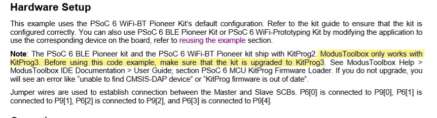

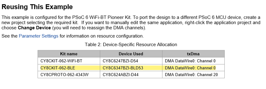

The first thing to note is the Hardware Setup which notes the KitProg on the BLE Kit must be at rev KitProg3 before it can be used with the ModusToolbox.
Also, the Hardware Setup describes how to connect the Slave and Master SPI signals from the Arduino Headers on the kit.

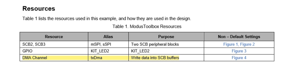

In the Resources section of the  CE221120 doc, the ModusToolbox Resource are shown.  In particular a DMA Channel has to be added to the project with the Alias txDma.
For the CY8CKIT-062-BLE, a DMA DataWrite 0 Channel 0 is required.

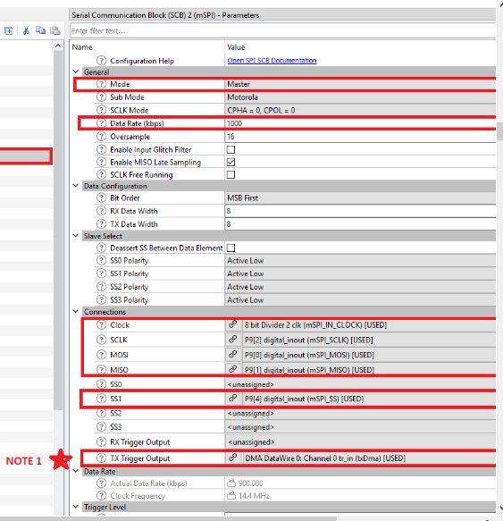

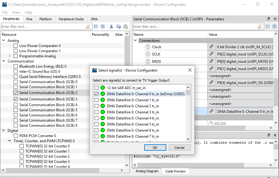

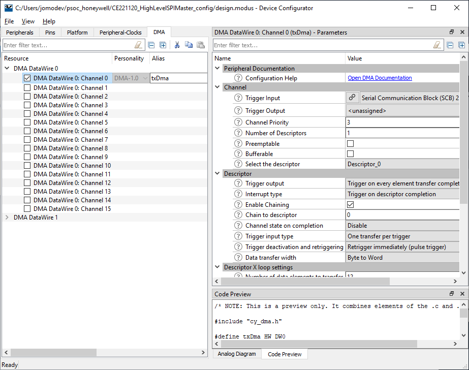

To add a DMA channel ModusToolbox project, the Device Configuator is used.
This can be launched by either double clicking the 'design.modus' file or clicking 'Configure Device' under the ModusToolbox Quick Panel.
Once the Device Configurator is open, click the DMA tab to add a DMA Channel.
See Figure 4. txDma Resource Configuration from the CE221120 doc for the proper settings.

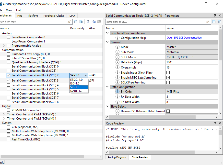

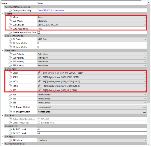

Once the DMA channel is added, this needs to assigned to the appropriate SBC. In this case it is the SPI Master SBC 2 where it is used to send the data to the SPI Slave.  Also, note the other settings for SBC 2 as described in the CE221120 doc.
The SCBs can be accessed via the Peripherals Tab in the Device Configurator and assigning it to TX Trigger Output under Connections.
The SPI Slave SBC 1 connections are configured as follows.
The SBCs can be configured as either a EZI2C, I2C, SPI or UART from the drop down list box the right of the Communication listing of each SBC.

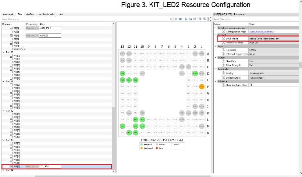

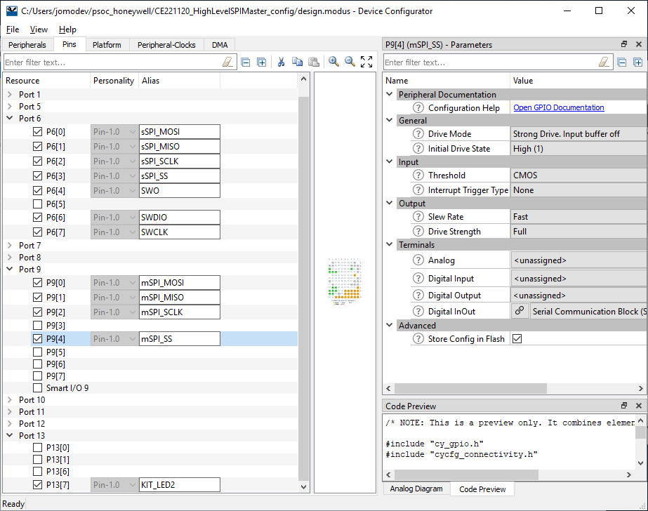

The KIT_LED2 (RED LED at LED9 Port 13 Pin 7) may need to be configured if not already set.  This is used to indicate that the data transfer between the Mast and Slave SPI interfaces has completed.  This is under the Pins tab in the Device Configurator tool.
The SBC and LED Pins assignments are as seen here:

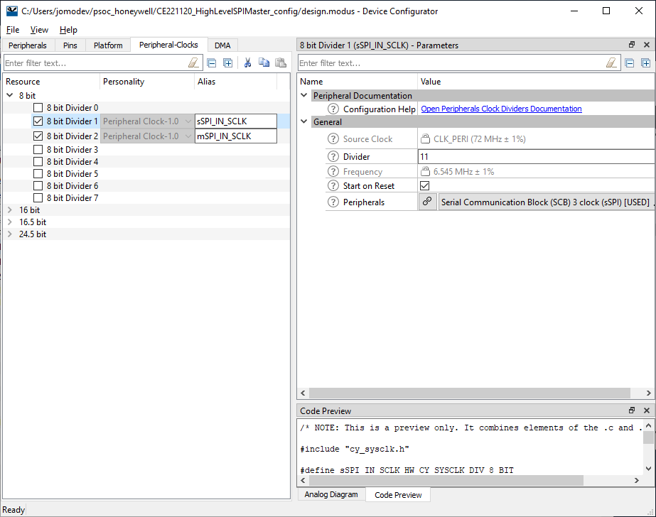

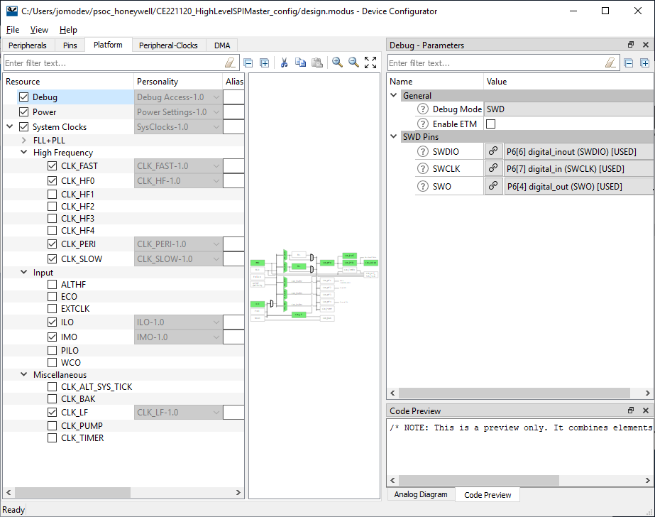

Ensure the clocks listed under the Peripheral-Clocks tab are set as follows:
Under the Platform Tab, the Debug port assignment is set  to SWD mode.
Once all of the changes are made in the Device Configurator, Save the changes and close the tool.

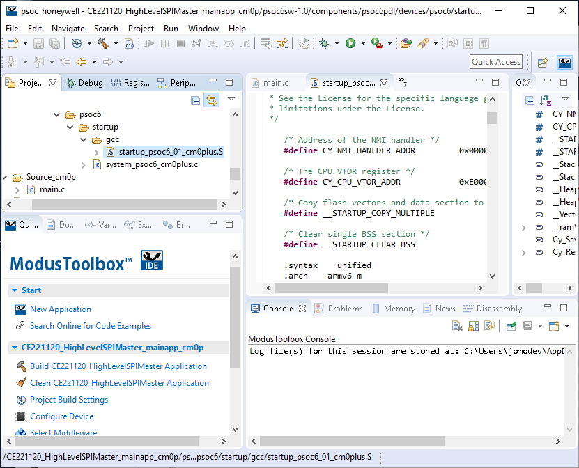

One note, as previously mentioned, before the project is built, it is best to replace the startup file with the updated one from the Cypress Community posting.
https://community.cypress.com/thread/42859?start=15&tstart=0

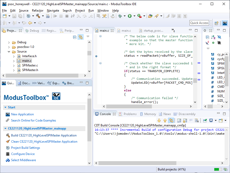

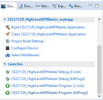

In the ModusToolbox IDE, it is best to clean the project if changes are made in Device Configurator to ensure no leftover configurations are still active. This can be performed by clicking
  Clean CE221120_HighLevelSPIMaster Application
under the Quick Panel tab and CE221120_HighLevelSPIMaster_mainapp selection.
After cleaning the  build, it is best to Rebuild the Index for each project folder.  This is performed by right clicking on a project folder and selecting 'Index' Then 'Rebuild' to rebuild the Index.  Then right click the project folder again and select 'Index' and then ' Update with Modified files'.
Then build the project. This can be performed by clicking
  Build CE221120_HighLevelSPIMaster Application

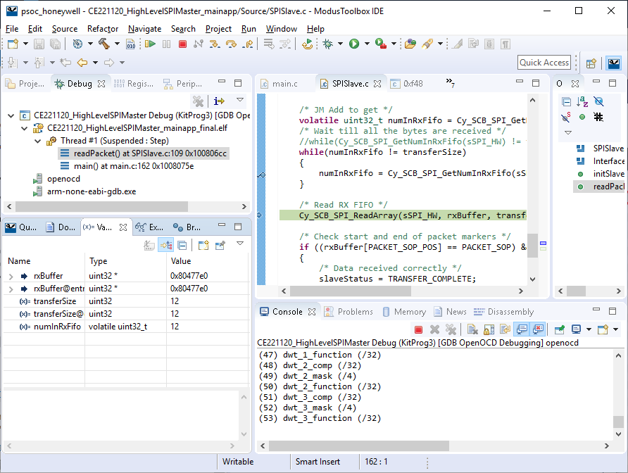

Once the program builds successfully, there are two options the load the code on the PSoC 6 board; Debug or Program with either a J-Link or programmer or the builtin KitProg3 programmer.  These are listed under Launches in the Quick Panel.
As in a typical Eclipse IDE, if the Debug option is used, then the Debug session will be started allowing the code to be stepped through one line at a time or adding a Breakpoint to stop the code at a particular point. If the example was configured properly, the KIT_LED2 will blink each time the code completes a loop through the data transfer or every 1 sec if the code is loaded on the board.
Example of a Debug session.
Once the code is running properly, the KIT_LED2 should blink every second indicating the data transfer was completed.
