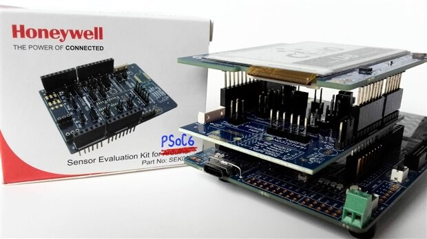

Part 1:
The SEK002 Sensor Evaluation Kit consists of an Arduino R3 compatible shield and some software, which includes firmware for an Arduino and a Windows-based software application for reviewing live data on a laptop or PC.
But, we all know that an R3 compatible sensor shield is not just for Arduino, as most will work perfectly with the PSoC 6 BLE Pioneer Kit, or with any other development board that uses the R3 compatible pin configuration. It is only the Arduino firmware and the windows software executable that are not compatible with the PSoC 6 straight out the box. Anyhow, this firmware and software is not needed to produce creative PSoC 6 based applications.
So let's get started.

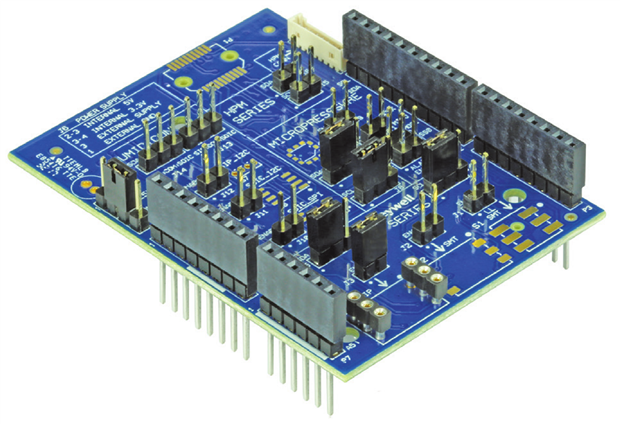

What is the Honeywell SEK002 R3 sensor shield
Image source: Honeywell datasheet.

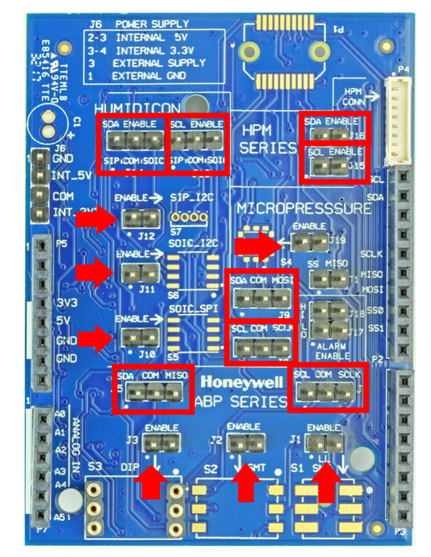

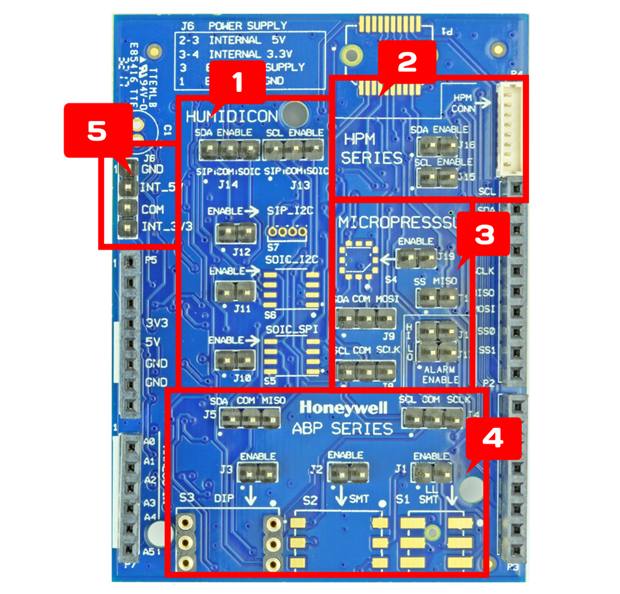

The SEK002 R3 sensor shield provides compatible SMD footprints and through-hole SIP/DIP connectors to allow the user to test and evaluate the following Honeywell sensors:
  • HumidIconTm Digital Humidity/Temperature Sensors (HIH6000, HIH6100, HIH7000, HIH8000, & HIH9000 Series) – which I’ve marked as zone 1 (see below);
  • Particle Sensor (HPM Series) – marked as zone 2;
  • MicroPressure Board Mount Pressure Sensors (MPR Series) – marked as zone 3;
  • Basic Board Mount Pressure Sensors (ABP Series, digital versions only) – marked as zone 4.
The area marked as zone 5, is for power selection. Here, the user must use a jumper (shunt) to manually select either 3v3 or 5v as the operating voltage for the shield.
If you are unfamiliar with the board, it is worth your while watching this YouTube video from John Lachenmayer (introduces himself as a Honeywell Field Application Engineer). This video provides a nice overview of the Arduino R3 shield and introduces the different sensors that can be attached to the shield. It also demonstrates how to use the shield using an Arduino micro-controller and then focuses on the Honeywell analytical software, which is not applicable in our case.
One thing to note about the shield is that it is designed to allow the user to manually enable any sensor that has been mounted on the board via a jumper (shunt).  The user is then also required to enable and select whether the sensor communicate via I2C or SPI. These are marked as follows:

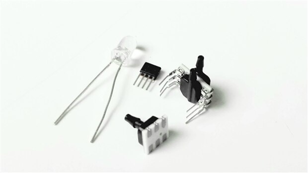

Looking at some of the compatible sensors
The big surprise I had with the sensors I ordered was how small they all were.
Let’s look at these sensors in more detail.

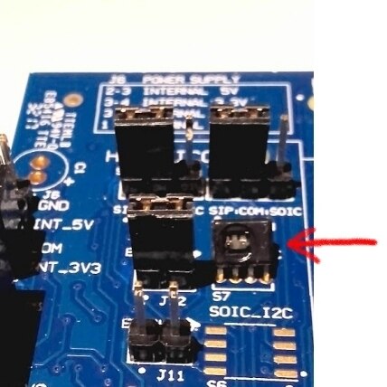

Honeywell HumidIconTm Digital Humidity/Temperature Sensor (HIH8000 Series)
The Honeywell HumidIconTm Digital Humidity/Temperature Sensor is a digital output-type relative humidity (RH) and temperature sensor combined in the same package. The sensor provides a ±2.0 %RH accuracy and a ±0.5 °C Temperature accuracy. The temperature sensor has a -40 °C to 125 °C [-40 °F to 257 °F] operating temperature range and the humidity sensor natually operates in the 0% to 100% RH range. The sensor operating voltage is 2.3 Vdc to 5.5 Vdc. The sensor consumes only 1 μA when it goes into sleep mode, following a measurement, versus 650 μA when taking measurements.
The user can choose a sensor based on the following options:
  • I2C or SPI bus
  • SIP 4-Pin or SOIC-8 SMD
  • a hydrophobic filter or with no filter
The specific sensor I ordered was the HIH8120-021-001 sensor, which operates as an I2C slave (address 0x27 with a 14-bit resolution for both humidity and temperature measurements), it does not have a hydrophobic filter (see photo) and it comes in a SIP 4-pin package.

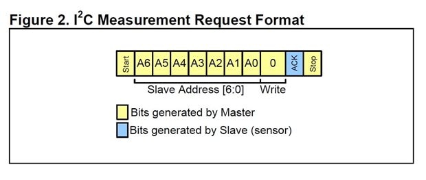

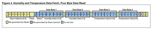

To obtain a measurement from the sensor, you first make a “measurement request”. This is done by simply sending an I2C WRITE command, as illustrated:
Image source: Honeywell Technical Note on I2C communication with HumidIcon Sensor

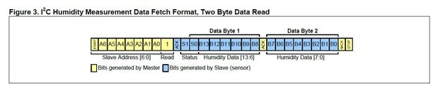

The sensor will, according the datasheet, then take 50-60ms from power-up, i.e. when the write request is received, to when data is ready to be read.
To read the data, you simply send a READ command and then send an ACK after every byte read and then a NACK and a STOP command to say “that is all, thanks”.
To test the validity of the data received, you then need to read the Status Register (S1 & S0) values. The following conditions can apply:
  • S0 & S1 are both zero (0) then you have “fresh” data.
  • S0 = 0 & S1 = 1, then you have “stale” data. This can mean two things. The first, which happens if you try to read the data immediately after a Measure Request, is that the sensor did not complete its calculation. The second is that you are reading the data again (as in, its “stale” data).
  • S0 = 1 & S1 = 0, then you are in “command mode”. Command mode allows you to configure the sensor, by writing to sensor EEPROM, alarm threshold values etc. You can refer to Honeywell’s Technical Note on how to use Command mode.
  • S0 = 1 & S1 = 1, is not used – regarded as a diagnostic (failure) condition.
As shown in the diagrams above, both the humidity and temperature values are stored in 2 bytes each. You are then required to do some bit match to obtain the 14-bit values. Then it is a matter of applying formulae to covert the 14-bit value in %RH and temperature in degrees Celsius. A further conversion is required for a temperature in degrees Fahrenheit.

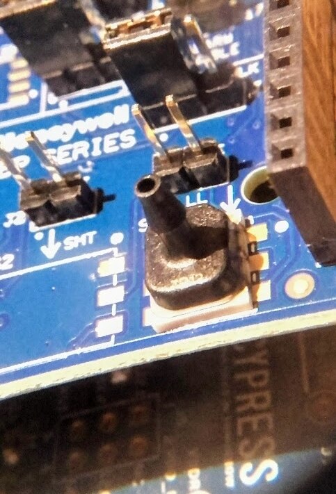

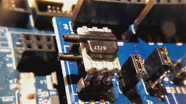

The specific sensors I ordered were:
1 The  ABPDRRT005PG2A5ABPDRRT005PG2A5 Dual Radial Barbed Gage Differential Pressure Sensor
This sensor has the following properties:
  • 5VDC supply voltage
  • Operating current of 3.7mA
  • Digital I2C bus (address 0x28)
  • Maximum pressure range up to 5 psi
  • Silicone gel coating, suitable for liquid media
  • Transfer function provides 214 counts (measurements) with no temperature output enabled, no diagnostics and no sleep mode

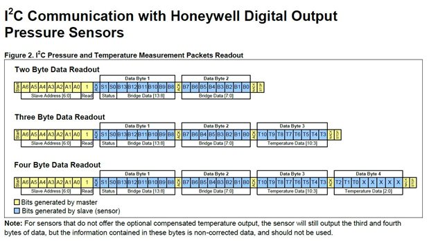

Unlike the HumidIcon Temperature & Humidity sensor, there is no need to first make a “measurement request” using the WRITE command.  To speed things up all you do is send the sensor a READ request and within 3ms (according to the datasheet) you will receive the answer.
The format is as follows:
Image source: Honeywell Technical Note on I2C communication with Pressure Sensors
Similar, to HumidIcon sensors, to test the validity of the data received, you read the Status Register (S1 & S0) values. The same rules apply:
  • S0 = 1 & S1 = 0, then you are in “command mode”. Command mode allows you to configure the sensor, by writing to sensor EEPROM etc. You can refer to Honeywell’s Technical Note on how to use Command mode.
The pressure sensors I am using do not provide temperature information, so only 2 bytes of data need to be read before a NACK and STOP command is sent by the master controller.

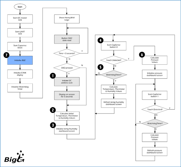

Setting out my PSoC 6 project application workflow
For my project application, I have set out 7 key steps to completing the PSoC 6 firmware:
  1. I2C register scanning to detect any slave devices
  2. Calculate the relative humidity and temperature values
  3. eInk Display Function
  4. Capsense Functions
  5. Watchdog timer routine
  6. Calculate Pressure values
  7. BLE data transfer services (time permitting)
Step 1 is now complete and this is the basic code hack (code sits in main()) that I came up with to scan for devices and calculate the humidity and temperature values (the formula in the code was taken from an Arduino example found online - I have yet to validate):

                                        T_dat = T_dat / 4;
                                        T_C = (float) T_dat * 1.007e-2 - 40.0;
                                        printf("Your Relative Humidity is: %.1f%%\r\n", RH);
                                        printf("Your Temperature is: %.1f\xB0 C\r\n", T_C);
The output from this code is sent to UART for viewing on a Serial Monitor. Here is a short video showing this output, when I have the PSoC 6 EPD Display Shield mounted too:
So, so far so good...
I will update my blog (part 2) once I’ve completed the next steps and hopefully reveal a working medical application.
  • BigG
    BigG over 7 years ago +4
    Just thought to share a quick update. Workflow stages 1 - 5 complete and I'm now thinking through the final phase 6 and phase 7. I've tested my pressure sensor and I'm getting pressure values via my level…
  • BigG
    BigG over 7 years ago in reply to DAB +2
    Thanks. Yes, will be interesting to see how the pressure sensors work out. My pressure test apparatus is almost ready...
  • geralds
    geralds over 7 years ago +2
    Very fine! You presented a nice latte. I hope I bring my project so well. I'm looking forward to your 2nd part. Best Regards Gerald ---
  • BigG
    Workflow stages 1 - 5 complete and I'm now thinking through the final phase 6 and phase 7. I've tested my pressure sensor and I'm getting pressure values via my level shifter (my sensor is 5V), which is great. It's worth noting that the sensor does work via 3V3 but this then needs recalibrating the count values etc. and won't be as accurate.
    One part missing from my project workflow is adding in the liquid level cap sensing for the syringe. That could well be hit or miss, we'll see. I did some prelim testing using foil as I don't have copper tape.
    As a fall back, I'm adding in a BLE Bridge to push pressure data out using the Automation IO Service (0x1815) via an Analog output characteristic. This service lends itself very well to this sort of thing. The really cool thing is that you can specify in the characteristic description what the data is etc. I can then use my PSoC 6 BLE kit's (CY5677) dongle to then read the data and have potential to then display on PC/Laptop via Processing or other software. Neat.
    Today, I got a big buzz out of seeing my humidIcon temperature value agreeing with the EPD Display Shield's thermistor.
