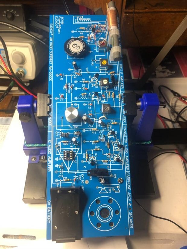

hello would like to learn how to measure components on my elenco am radio kit.
am new to electronics, trying to figure things out.
read about lissajous patterns, just need some direction as to how to set up my connections, see if components are functioning as necessary.
my 9 volt battery gets hot, no audio output,so  i think i have short somewhere?
thanks

    A photo of front and backside of your device would maybe help. We can help check if something is wrong or if there are possible bridges. Meanwhile, don't put the battery in.
    A battery running hot on an AM radio points to a shortcut.

    yes i can post pics of back and front.took battery Outland ic also.
    have looked on front and back by solders, but my untrained eye fails to pick up anything obvious.
    if u see something, let me know.

    0 Jan Cumps over 6 years ago in reply to johnwater
    The soldering is good. I see that most of the transistors are NPN. There's 2 PNPs that I can see (Q5, Q7). You have different part numbers for those?
    Electrolytic capacitors look correct (I can't see the symbol under C13 but when viewing the schematic, it looks that it's correct too).
    The diode is correct too.
    I don't see anything obvious.
    What is the resistance if you take out the battery and measure over the two solder points of the battery housing?
    Maybe double-check if this is repaired correctly:

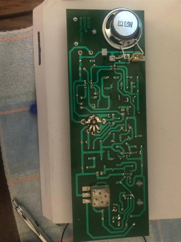

    0 shabaz over 6 years ago in reply to johnwater
    Also, this bit looked strange:
    Is something missing where the red arrow is pointing at a rectangular slot? To me it looks like the switch (marked with blue arrow) isn't connecting, because nothing is connected to that rectangular slot, so power cannot be enabled into the circuit.
    It doesn't explain how the battery could be getting hot though! That's the opposite to what would be expected..
    Maybe a second photo is needed of the PCB, I just can't tell from that angle.

    0 Jan Cumps over 6 years ago in reply to shabaz
    Looking at the potentiometer, it seems that it has been inserted from the wrong side (inserted from above instead of pushed in from the underside)..
    The movable switch part looks forced (blue), and the right connector of the switch is above the PCB instead of below, on the solder pad (red).

    0 Jan Cumps over 6 years ago in reply to Jan Cumps
    The unsoldered contact can't create a shortcut.
    But this may be the cause:

    0 shabaz over 6 years ago in reply to Jan Cumps
    Ah, I see, you're right... You mean the switch pole is bent and hitting the shell, right? Yep, that could do it, if the wiper is touching to the shell and the volume is turned down : (
    I'm so used (like you probably) to seeing this type of reverse-mounted switch/pot from 20th century consumer radios : ) but I can see it could be a confusing component for any newcomer wishing to solder it on!

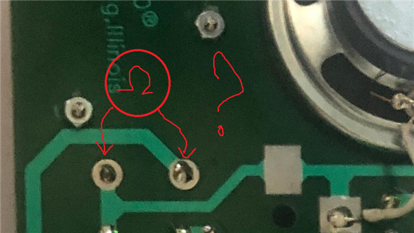

    the other area circled was a screw up of mine where the copper shield came off.Called elenco and tech said to just solder longer leads to meet the other connections, which i did.these aeremitter of Q4 and+ of capacitor C12,and negative lead of C12 to resistor  R15.and they all show good continuity..
    i should have enclosed a parts list for you.

    0 johnwater over 6 years ago in reply to shabaz
    i took the knob off of pot so we can see underside better.the nut and washer fit on top side of board, there are 5 lugs to solder on bottom of pc board.
    looking at 3 of the lugs i will re-solder those to fill holes better,
    everything is soldered from the bottom ,not on top of board.
    how would i check to see if this pot is shorting out somewhere?
    Hi John,
    You can use your multimeter set to ohms to check any component that isn't in-circuit any more.
    1. Is the metal indicated to by the red arrow soldered or touching the body/shell metalwork? I don't understand why it isn't soldered to the adjacent rectangular slot in the PCB, basically. And also, if it is touching the shell, or soldered to it, that could be an issue.
    2. What's the resistance between the shell, and each of the three contacts for the variable resistor?
    3. And also, is the switch mechanism (blue arrow) touching the shell tab (green arrow)? If so, that could be an issue too, because it isn't supposed to be touching the shell tab. Again, this can be verified by the multimeter set to ohms and measuring from the switch contacts to the metal shell (do this for both of the switch contacts).
    An understanding of what this component is doing is needed; two of the contacts are intended to work as a switch, and the remainder three contacts serve as the potentiometer or variable resistor. The switch contacts should be electrically isolated (i.e. extremely high resistance, 0L on your meter) from the three potentiometer contacts _and_ the shell. If that's not the case, there is an issue.
    shabazi believe you are right.
    one of the wiper pins is physically touching the base of switch,vom shows low resistance, almost like a short.
    i am going to take whole switch off and realign and report back .
    Taking off the switch is not easy, once the pins are soldered. It may be easier to try and desolder only that one that's mounted in the wrong hole, and place it in the correct hole.
    If you can't get it out, clip it as close to the PCB as you can, then use some wire to bridge the gap.
    It will impact the strength of the construction though. The 2 switch contacts also play a role to keep the potentiometer from twisting in place ...
