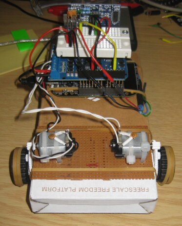

I have the Arduino Motor Shield working, the Ultrasonic module is pinging around, Christmas brought some small DC toy motors, and a bag of plastic gears is on my desk. All the good ingredients for a small robot: the Freedom Robot!

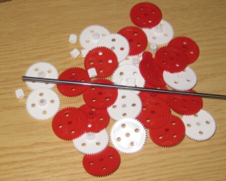

Looking around for ’round things which could be used for wheels’, I was first thinking of using old CD’s. I made some experiments, but the two DC motors did not give enough torque. So I abandoned the idea and switched to a ‘small wheel + gear’ model. And a bunch of plastic wheel parts were available:
plastic tooth wheels
:idea: My local electronic and hobby store sells such wheels.

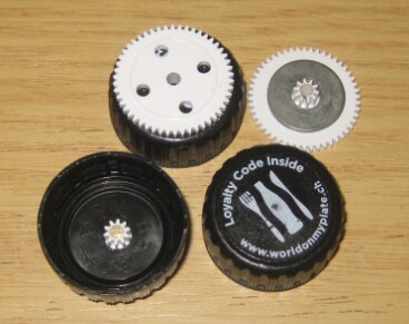

As wheels I have found that the plastic caps of soda bottles would be an option. So I have made my decision to use the caps as wheels:
Plastic Bottle Caps with plastic tooth wheel
I simply drilled a hole into the center of the cap, slightly smaller than the inner tooth wheel of the plastic gear. Then pressed the inner tooth wheel into the cap. To compensate the distance, I used a metal ring.
:!: Make sure you have several caps available. I destroyed several ones until I have found the ‘perfect’ fit. Alternatively it is possible to glue the tooth wheel to the cap.

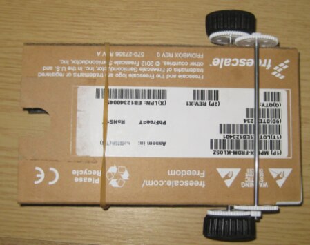

Then the wheel gets put on a metal rod:
Wheel Cap with Metal Rod

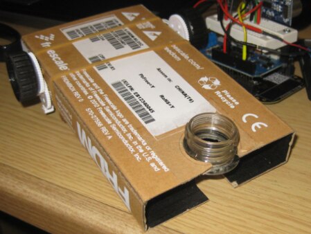

Chassis
Question: What could be the chassis for a Freedom Robot?
Answer: The Freedom Box!
Actually, the FRDM-KL25Z cannibalized the box of the FRDM-KL05 board ;-) :
Freedom Chassis

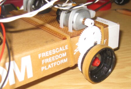

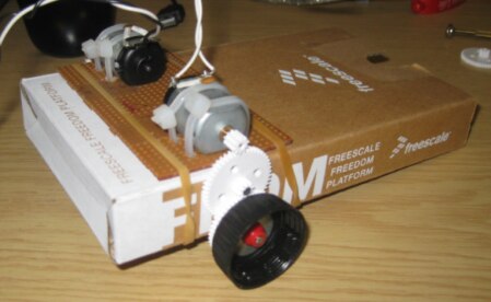

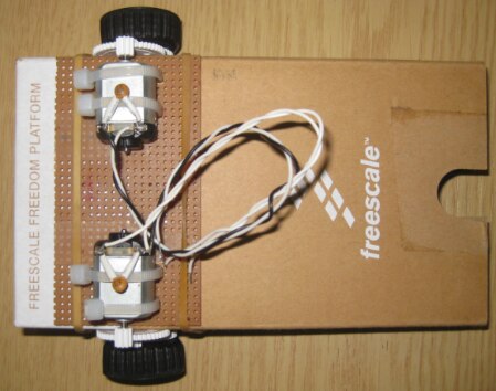

The metal rod is going through the box. And a second rod with gears gets added. Both rods get drilled through the box.
The two DC motors get mounted on top of the box.Two rubber bands help to keep the motors in place:
Motors attached to the gears
Motor Chassis Top View

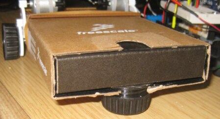

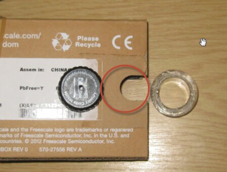

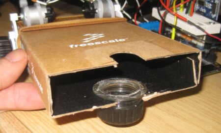

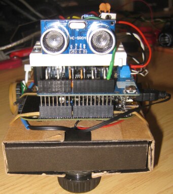

Two wheels are not enough: something else is missing to stabilize the chassis. One way is to use a third wheel, or to use a ball or similar which rolls on the ground. I have found that the plastic caps are usable too: they are cheap and available, and serve as a ‘ground slider’ if there is not much friction:
Position for ground slider
With a cap I draw a circle and cut it out. To attach the cap, I have cut the top-most part of an (empty!) bottle:
Top of Bottle mounted
Then the cab gets mounted:
Cap mounted

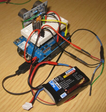

Power Supply

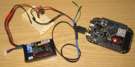

For an autonomous robot, batteries are needed. The Arduino Motor shield has a dedicated motor power supply connector, and it can pass the motor voltage to the FRDM-KL25Z board.
:idea: In general it is a good idea to separate the motor power from the microcontroller. To keep things simple, I used only one battery.
But this would only give 3.3V to the FRDM-KL25Z, and no 5V which are needed for both the motor shield and the ultrasonic sensor. The FRDM-KL25Z has a coin battery holder, but again: no 5V :-( .
The best option I have found is to give 5V through the USB connector (either OpenSDA or KL25Z). For this an old L7805CVpositive voltage regulator from STM was right at hand. To connect it to the Freedom board, a USB cable got hurt for writing this article:
Powering though USB
As battery a LiPo with two cells (7.4V) is used to power the motors, and the L7805CV generates the 5V for the Freedom board:
LiPo Powering Boards and Motors

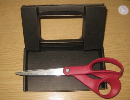

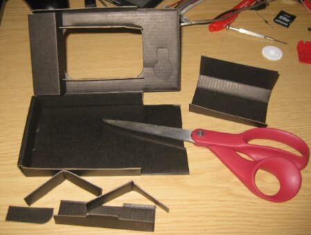

Why not place the battery inside the freedom box? The black ‘inlet’ box could be easily used for this:
Inner Black Freedom Box

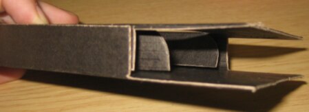

Remember that the two metal rods for the gears are going through the outer box? Well, that means that I need to cut some parts of the black inner box to make it fit again:
Cut parts of the black inner box
The result is a U-shaped inner box, with that U just fitting above and blow the two metal rods:
U Shaped Inner Box
That way the inter box fits into the outer box:
inner box fits again

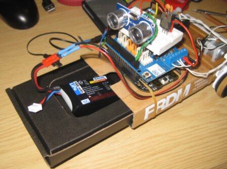

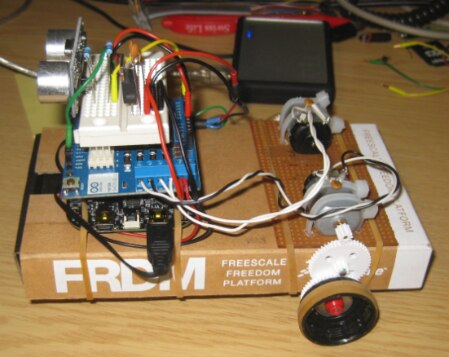

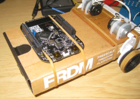

Two rubber band safety belts keep the Freedom board in place:
Rubber Bands for Freedom Board

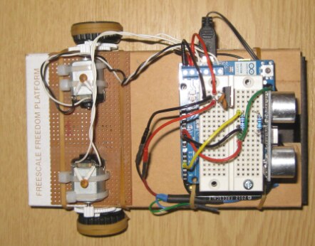

The Motor Shield and the Ultrasonic Module get stacked onto the Freedom board. And the battery fits easily in the inner box compartement:
Battery Compartment
With this, here is it: the Freedom Robot:
Front View
Side View
Back View
Top View

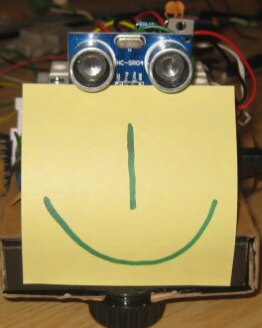

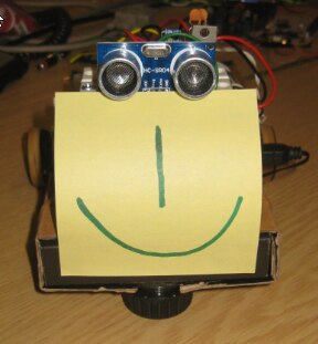

Oh, yes, one more thing: my daughter thought that this way the robot is *much* better:
Modding of a Robot
