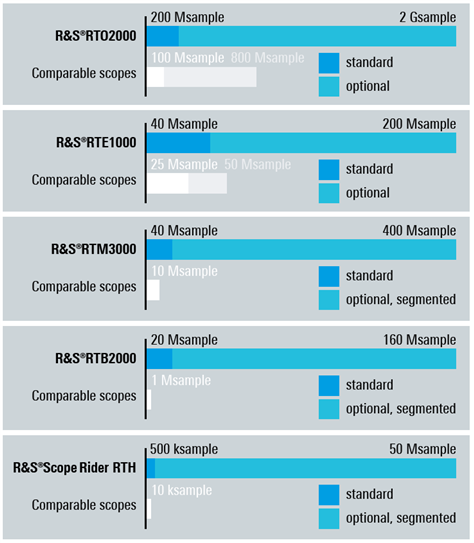

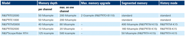

An oscilloscope with deep memory solves the described problem. Oscilloscopes from Rohde & Schwarz traditionally offer high memory depth as a standard. The different memory upgrade options offer an even greater advantage since users can capture an incremental number of segments at a specific depth. The table gives an overview of solutions from Rohde & Schwarz.

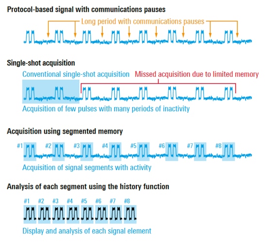

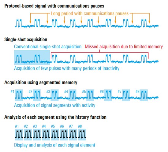

Segmented memory limits the acquisition to relevant signal elements. During signal acquisition with segmented memory, the available memory is divided into smaller segments, each with a defined number of samples. The user defines the length of the segments based on the relevant parts of the signal, e.g. the packet length of a protocol-based message.
At the trigger point, the data of interest is stored in memory along with the trigger timestamp. Time periods without interesting activity are not acquired. As a result, users optimize utilization of the memory, fast sample rates can be maintained and much more relevant data than with single-shot acquisition can be recorded.
Segmented mode is particularly useful for capturing bursts of activity surrounded by long periods of dead time. Many serial buses and communications signals fit in this category.
Single shot versus segmented acquisition

The history mode offers substantially deeper memory on embedded oscilloscopes. In history mode, a highly precise trigger timestamp permits precise time correlation of signal events. Users can scroll through past acquisitions and analyze the data using all oscilloscope tools, e.g. protocol decode and logic channels. Individually marked segments can be selected in the acquisition table for display. Alternatively, the history function can be used to automatically play back all segments.
The following table provides a competitive comparison. It turns out that oscilloscopes from Rohde & Schwarz often offer more memory than comparable instruments, which is why those instruments are ideal when debugging embedded designs.
