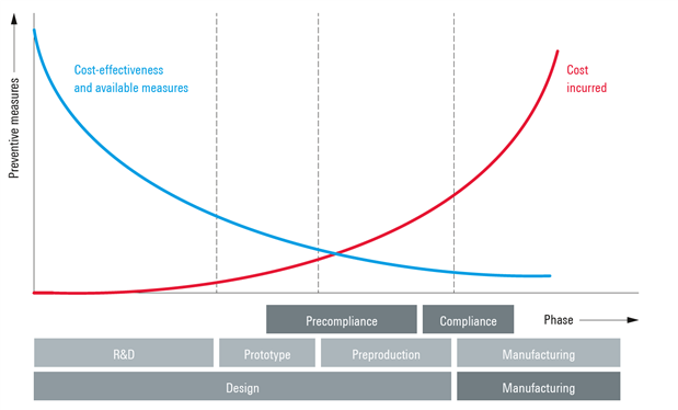

EMC testing in the product development
As illustrated in the figure, pre-compliance and debugging tests should already be performed early in the development process in order to ensure that EMC standards are adhered to. Also, the possibility of having to redesign a product due to EMC testing failures shrinks. This contributes to meeting the development budget and time-to-market.

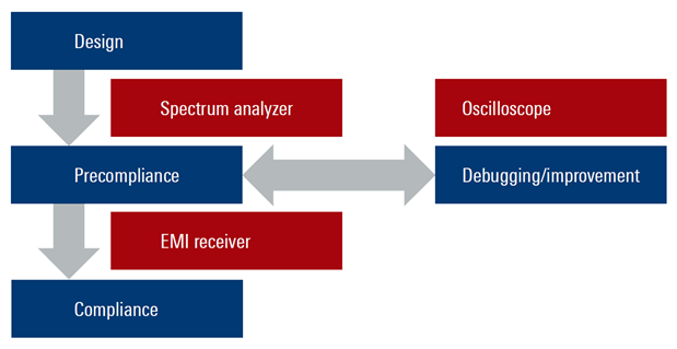

Basic EMI debugging process
In most cases, the development process turns out as a sequence of standard steps. Near-field measurements are used to localize the source of interference. After the noise source has been located, the behavior of the interference can be analyzed and corrective measures assessed. A final pre-compliance measurement is performed before going into the compliance stage. Each step requires continuous testing that can be performed by different types of test equipment. While pre-compliance, as well as debugging tests, are mostly done with the help of a spectrum analyzer respectively an oscilloscope, compliance tests are usually done with EMI receivers.
