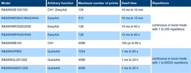

You can either program a new pattern directly on the instrument, load a .cvs file that can conveniently be compiled, or you can program the points via SCPI. For each step of the pattern, you can set voltage, current, duration and interpolation. The various models have different ranges for programmable voltage, current, dwell time, number of repetitions and number of data points. The following table summarizes these specifications for the R&S power supply portfolio.
