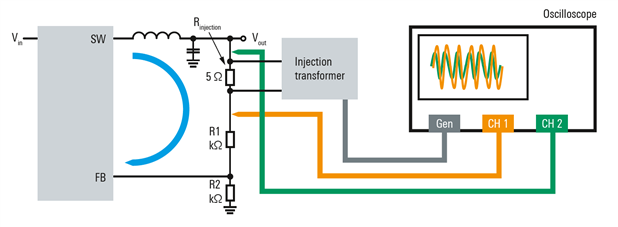

Control loop response testing requires injecting an error signal over a band of frequencies into the feedback path of the control loop. To inject the error signal, a small resistor must be inserted into the feedback loop.
The 5 Ω injection resistor (shown in the figure below) is insignificant in comparison to the series impedance of R1 and R2. Some users choose to permanently design in this low-value injection resistor (Rinjection) for test purposes. An injection transformer, such as Picotest’s J2100A, isolates the AC distortion signal and eliminates any DC bias.
Why is it important to choose the correct injection point?
To measure the loop gain of a voltage feedback loop, the loop needs to be broken at a suitable point. A distortion signal is injected at this point and distributed in the loop circuit. Depending on the loop gain, the injected distortion signal will be amplified or attenuated and shifted in phase. For the R&SRegisteredRTx-K36 option, the generator of the oscilloscope generates the distortion signal and the oscilloscope measures the transfer function of the loop. To ensure that the measured loop gain equals the real loop gain, a suitable point needs to be chosen.

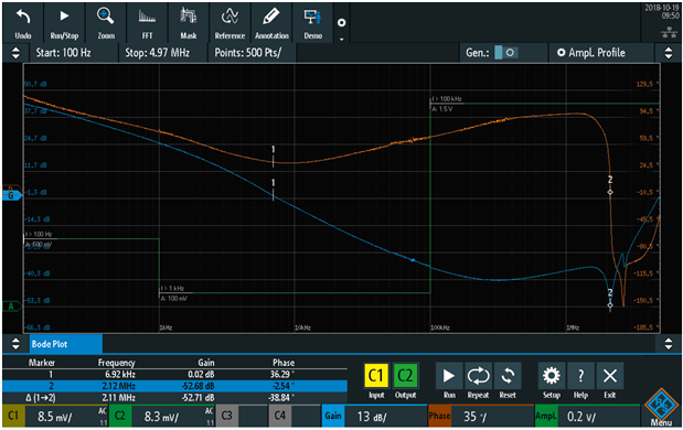

The curves displayed in the Bode plots represent the transmission function of your circuit and help verify the stability of your system. One graph (blue trace in screenshot) displays the amplitude behavior over the frequency range in dB, while the second plot (orange trace in screenshot) displays the phase characteristics over frequency (measured in degrees).
