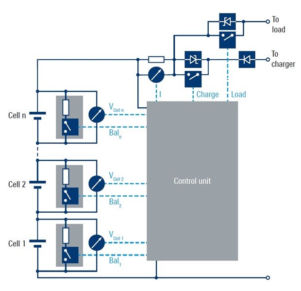

Larger batteries are typically built by connecting multiple cells in series and parallel. Since the same charge and discharge current flows through all cells, individual differences in battery capacity, self-discharging, etc. would lead to differing states of charge over time and consequently limit the capacity and lifetime of the battery.
The need of BMS
So-called battery management systems play a crucial role in battery life and fail safety. Such systems actively monitor, control and manage various battery cell parameters. Among others, a BMS is responsible for the following tasks:
  • Determining the stage of charge of each cell
  • Supervising the integrity and derating of each cell (state of health)
  • Detecting faults and exceptional conditions and preventing hazards such as overheating and fire
  • Balancing the stage of charge between the cells, which can be implemented in a passive way by selectively loading the cells
  • Thermal and energy management
Schematic of a battery pack with BMS
