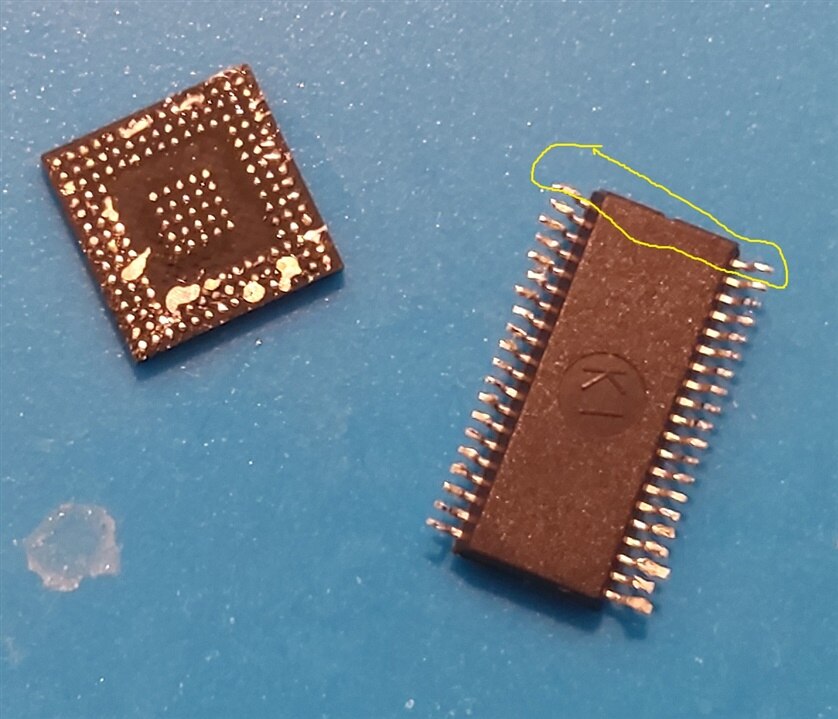

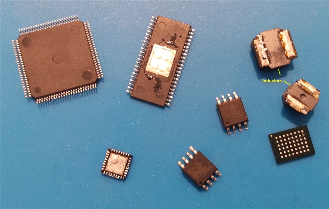

    Some success stories
    Some failures
    The left one, I'm not 100% sure if it's a failure, May be that some of the solder splashed up when the part lifted, and this is the residue. May be fixable.
    At least, nothing ripped.
    The right one didn't go very well. Two pins were still clinging to the board when the chip lifted.
    Damage: board OK, pins bent but can be fixed. Still: this could have gone wrong if the pad traces would not keep up with the pull tension...

    Andrew J over 3 years ago in reply to Jan Cumps
    Good job with the inductors, I always find them and electrolytic caps the hardest to de-solder.
    Jan Cumps over 3 years ago in reply to Andrew J
    My experiment with caps was a disaster. They explode inside the little oven.
