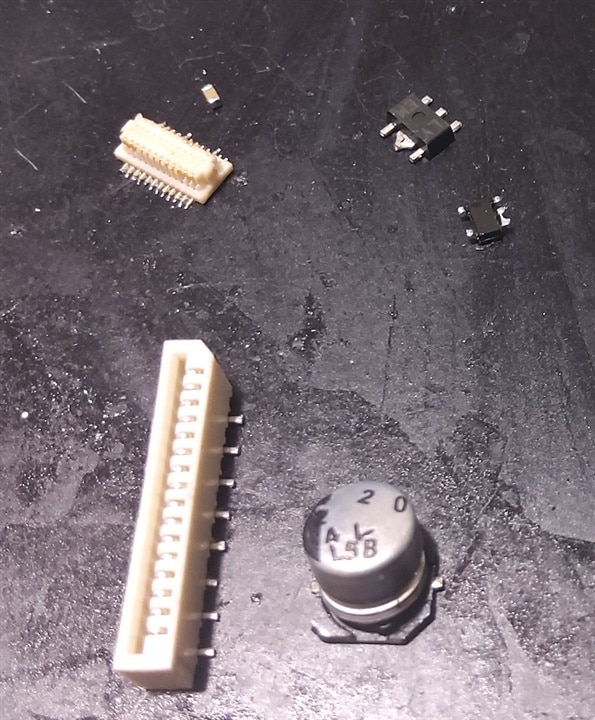

    I tried to use the ovens on non-IC parts: connectors, transistors, electrolytic caps. Without the lifting mechanism, just put the nozzle on top to concentrate the heat.
    After a few seconds, remove the nozzle, and complete the exercise with the air pencil and some tweezers only.
    In most cases, it made desoldering faster. With a few SMD plastic connectors, I managed to lift them off fast, before the plastic started to give away - something that fails often when I use an iron or heat gun in isolation.
    One thing failed miserably: an SMD electrolyte cap: that one exploded inside the little oven after a few seconds. Definitely not a good match with this desoldering kit.
    Action photo:

    For the connectors, one idea (I have not tried it) could be to obtain some ceramic paper, and cut a small piece into the shape of the inside of your metal cover, and pierce some holes or cut out notches all around the sides, so that all the heat hits the sides of the connector only. Basicallty the ceramic paper acting like the space shuttle tiles Joy The ceramic paper is cheap (it's used for art/craft pottery etc). However the suction won't suck up the part, but I guess for a connector the suction won't work all that well anyway, so maybe that's no big issue.
    (Just remembered I may have some of that paper, I'll take a look).
    Jan Cumps over 3 years ago in reply to shabaz
    I have Kapton tape. It doesn't have the same shielding, but I'll try it anyway ...
