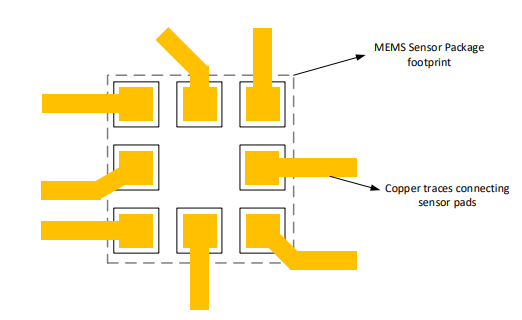

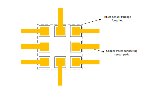

  • The traces connected to the pads should be as symmetrical as possible. Symmetry and balance to the pad connections will help the sensor self-align which leads to better control of solder paste reduction after reflow.

Figure 6: Asymmetrical trace and sensor pad connections
! Information of the PCB design and soldering processes provided in this document is considered for use as a reference. !
! PCB land design and connecting traces should be designed symmetrically !
Figure 7: Symmetrical trace and sensor pad connections
